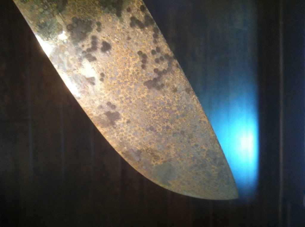

Heres a khukri I forced a patina on with vinegar soaked papertowel for about 30 minutes. The pattern of the papertowel made it look like snakeskin on the blade
After use the snakeskin look has worn away but a light grey dull patina still protects the blade.

And thank you for the forced patina pic, like the pattern. I really like the shine of satin, but know it will need upkeep.
Need2know - the blue satin waki was proxied for a buddy, but I couldnt resist gettin em both for a pic! I used white vinegar soaked cheapo papertowel - because the design on the papertowel will transfer to the blade. Let it sit in the sink tip down for about a half hour then removed the papertowel and rinsed it off, when i rinsed it some of he darker grey patina washed off. Next time i do it ill probably let it sit for anoher 10-15 minutes before rinsing it after i take the papertowel off.
I dig that patina pattern, something to consider if I decide to mix things up a bit. Shiny Satin has my attention right now.
