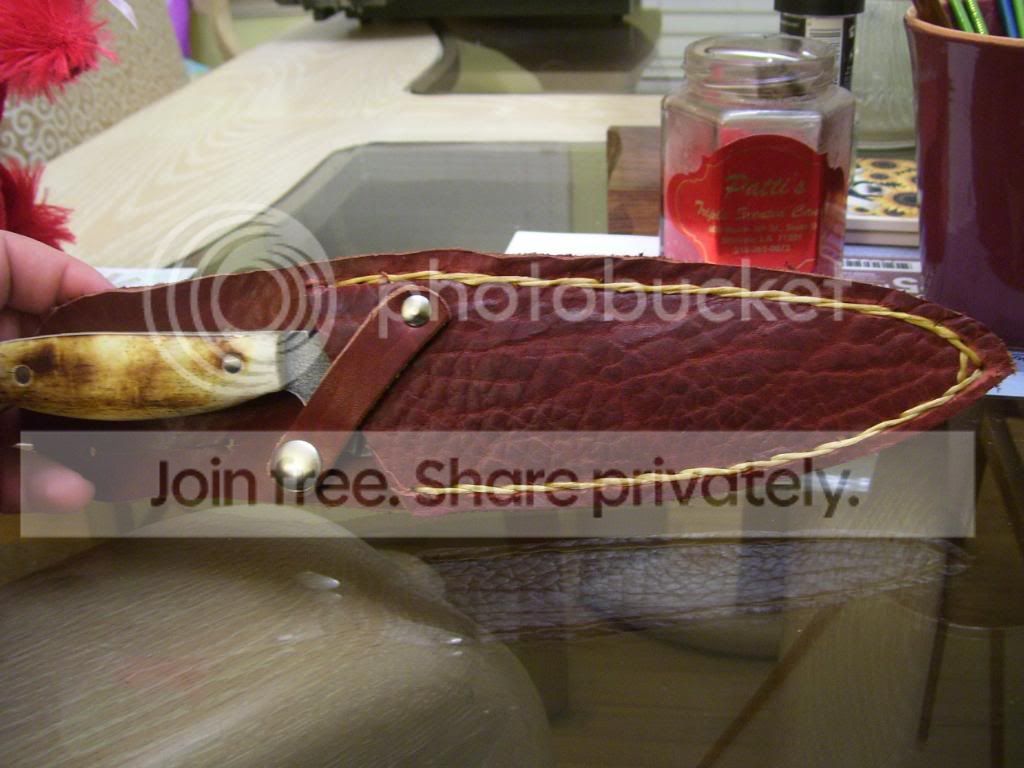

Like this?
If this is what you're talking a bout, it's fairly easy and I could just tell you how to do it.
Just stitch in on one side and out on the other? Someone over the sheath forum had one awhile back but I can't quite remember how he did it. If I remember right I believe it was William Crump that did it...
Basically come up through the bottom (and out through the face-side of the sheath), skip a hole and go through to the back. From the back, come up through the skipped hole to the face again, making sure your needle comes up on the desired side of the thread. It doesn't really matter which side it comes up on, as long as you're consistent with it for every stitch. Skip and hole again and repeat. The patterned stitch will only be on one side. The other side will look like a regular saddle stitch.

You nailed it there, Mr. Burgess. Easy as that.
