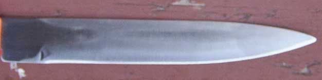

Here is a cheap kitchen knife with a typical low hollow grind. This is the same type of grind found on scandinavian knives, this one just has a really obtuse secondary bevel.
This is what it looks like after one minute of grinding on a slack belt. It is actually difficult to grind this knife because since it is so thin (1/16") it heats up with just one pass on the belt unless really light force is used :
The hollow grind has been removed and the secondary bevel very reduced. The primary grind is now convex and is coming down from the spine and up from the edge. With more work these will intersect and the blade will go from sabre/hollow to full convex like an opinel.
Razorback - Knives said:
if you hollow it back out, what the purpose of even trying to convex a hollow grind in the first place?
When I sharpen my Jess Horn flat to the stone I am not doing it to try and create a convex primary grind. I am doing it because I want the edge sharpened at about 7/8 degrees per side and that is how low I need to go to get that angle. Now as I sharpen the edge will widen and the shoulder of the grind starts to flatten and eventually they will meet as the bevel went from hollow to flat. This isn't a good thing because now I am sharpening a huge bevel which is over a cm wide. Thus I get it hollowed back out again and now the edge is again only a fraction of a mm wide.
With the rotary platen I have, I can achieve flatter convex grinds then a standard slack belt attachment would give me.
The amount of curvature induced will be dependent on the pressure and the tension in the belt. You can even grind them on a flat platen by rotating the knife. I have knives with primary convex grinds which were even ground on an angle grinder. Many traditional makers grind them with wheels and files. You can go very thin or thick or vary the curvature simply by how the blade is presented to the abrasive.
-Cliff

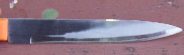

Here is an examples of such a grind, hollow to convex (a very flat convex, taper is less than 1-2 degrees from shoulder to apex) :
I have been doing a lot of work with this recently and you can see the edge has widened and actually intersected with the primary grind in the middle of the blade.
This isn't a good thing because now when I sharpen I have to remove more metal to restore the edge. This should be restored to a hollow grind on a wheel. Krein does this really well.
-Cliff
