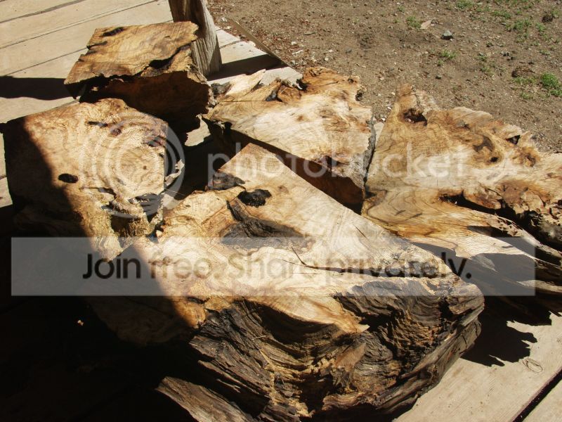

I spent the weekend getting my work area cleaned up in between dealing with all the tourists. As I was looking around liking how neat things were looking one of the workers here dumped this stuff on my porch.
When I asked, what the heck? He said "Harvey thought you'd want this for knife handle wood". This is was a big chunk of olive burl that has been under a tarp for a few years so it could color up a bit.
Olive burl is a PITA to cut up. The underground burl likes to hide rocks. I usually find them with my saw blade.
If you guys like how this looks I will cut it into handle blocks.
Let me know what you think. Because if nobody wants some, I have plenty of other work I should be doing.

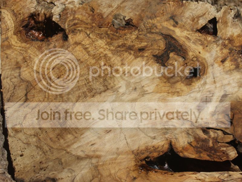

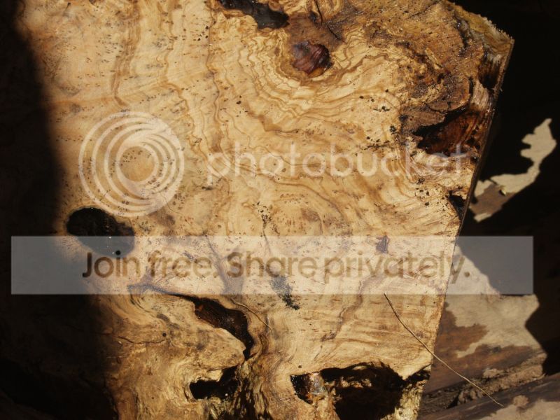

I started cutting these pieces this afternoon. Now I remember why I don't cut up olive burl very often. ROCKS!
But on the good side. The wood is looking real nice. Cool colors and some have good figure.
I just cut through my 4th rock so I will probably wait to get back to cutting until tomorrow.

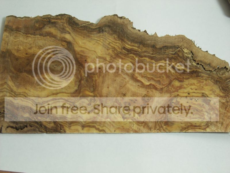

This is a piece I just cut. It won't all look like this but there should be some nice blocks come out of these chunks.

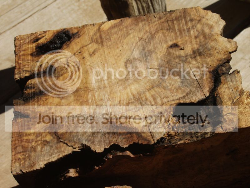

I used to get this stuff by the ton when we had our retail store in Sacramento. I agree...olive orchard wood can be most unstable stuff I know of. Not to say all of it is, of course. The burl form never seemed to stop cracking when drying it.
That is part of the challenge with cutting this wood. You have to map out the cuts to cut out cracked areas and pockets with dirt and rocks. For each block I get I waste about 2 times that amount of wood.
No where near as many cracks as with Madrone, Manzanita or Eucalyptus. I can see how this would never be a wood that would be viable for commercial production. Too much work and too much waste for what you get.
But..... the few good pieces you get after the cutting make it worth the effort in my opinion. At least with this one.
