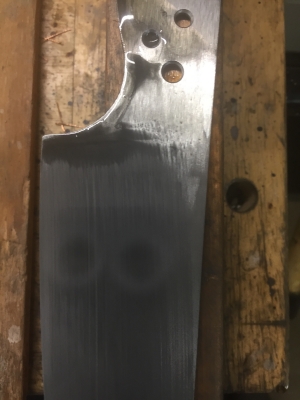

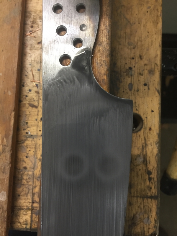

Hello all - got an interesting visual here. Take a look at this blade I'm sanding.
Notice the "eyes" in the blade? I'm not at all sure what's causing that. I'm sanding with 30 wt oil and 400 grit wet/dry paper. Now, when I wipe the oil away the eyes go away.
I can not see them at all - and it's not just a reflection, I can change lighting to vary reflection and the eyes are there with sanding oil/grit, but when oil/grit wiped away I can not see eyes even with blade moved around in lighting. Now, look at other side. The eyes are still there in same place, but opposite side. Eyes go away when the oil/grit is wiped away. Ever heard/seen anything like that before?

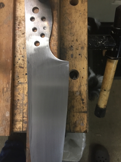

Well, I think I might have the answer. That blade was ground using the magnetic chuck for the surface grinder. While the blade didn't seem to have any magnetic properties, the blade didn't show any attraction to iron pin, etc I suspect there were magnetic artifacts left from the magnetic chuck. I placed blade on a demagnetizer and that took care of the problem - no more eyes. The oil/steel particles simulated a ferro-fluid that is really sensitive to magnetic field.
Comments from ya'll - does my thinking make sense?
