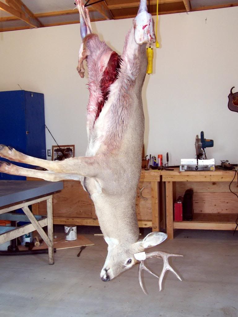

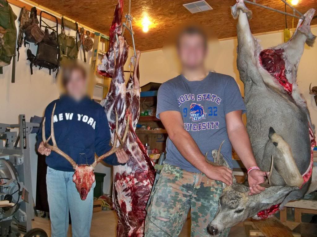

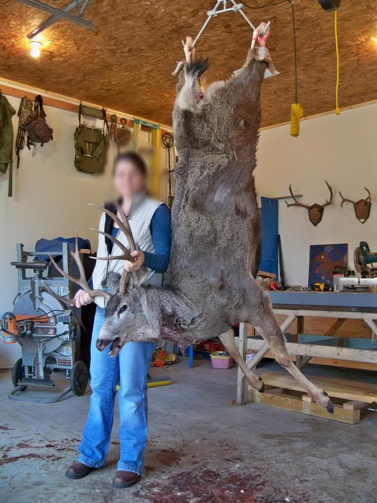

I tried to look back through some of my hunting pictures and see if I had something that showed the pelvis split. These were the closest I could find of deer hung head down for skinning, after the pelvis had been split when the guts were removed.
Even bigger bodied deer aren't coming off the gambrel during skinning with a split pelvis.
The pelvis is just split on the anterior side, no way are those deer coming apart without some steel. :) By the way, I'm not saying you need to split the pelvis for gutting deer, I generally don't unless I'm hunting with my father who always does. Then it's quicker for me to go ahead and split it than to get the lecture on how to do it right :) :D

Ok, so when you split it, you are opening up the channel that the urethra passes through, but not cutting through the top (if the deer were standing.) Is that right?

That is correct.
I see. Thanks. I don't think this will do much for airflow, but then you didn't mention this as your reason.. The hip joints would not really be affected. So you only do this for removing the ends of the digestive tract, I assume? Or do you see some other benefit?
