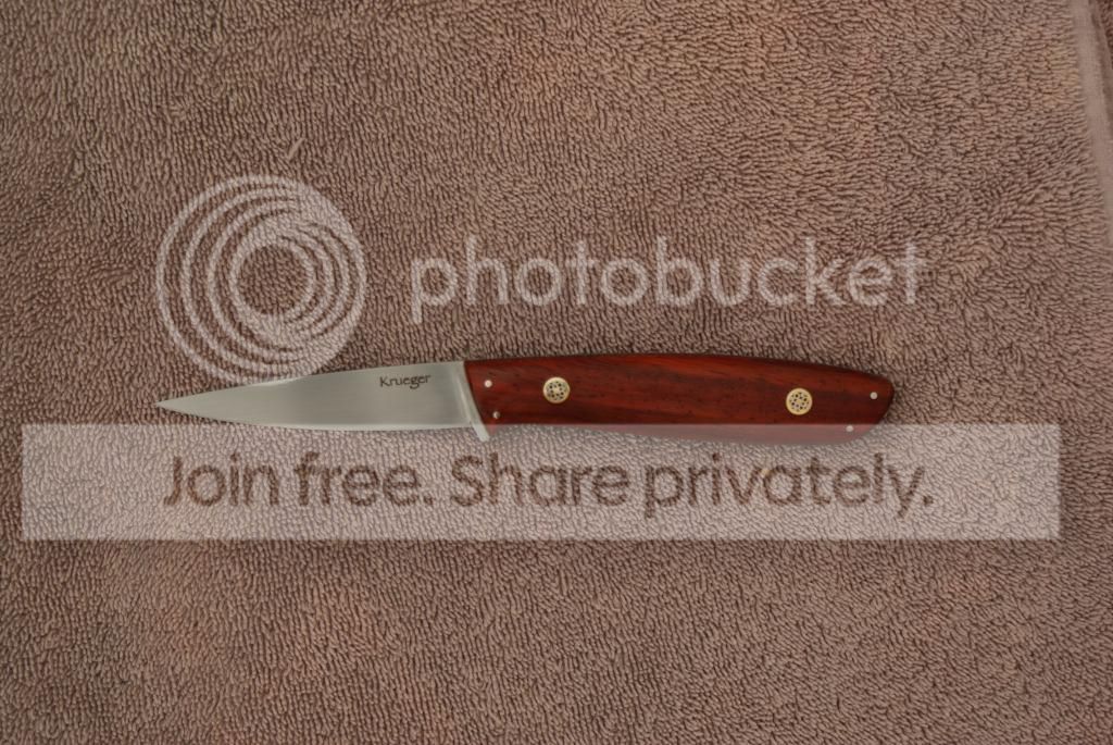

Here's a picture of the first knife that bears my maker's mark. It's for my mom, she broke a favorite paring knife a while back and I said I'd make one to replace it. It's O-1, HRC 62, 600 grit hand sanded finish. Scales are paduk with 416 SS pins and brass & stainless mosaic pins. Getting the appearance I wanted on the mark took some experimenting. I built an etcher using a 12/24 volt transformer and got my stencils from Ernie and used chemicals from USA Knifemaker. I think I'm satisfied with the results.
-Kurt
Personally I like the mark you ended up going with on that paring knife. It looks clean and well defined. Nice job!
