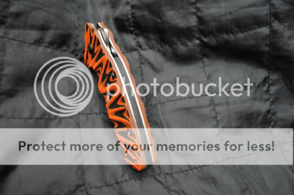

Solidorange now owns this one I did a while back. Its slightly thinner than the stock model but it feels so much better with G10 rather than the plastic.
I'm "that guy" who know owns it! It's a sweet package that's nice and slim in the pocket. The assist is gone making it a very nice flipper. I tend to carry it at work when a knife clipped to the pocket is not doable.

Brian, very glad you are enjoying it! I like it much more without the clip too.
Does the normal plastic needs work have full liners, or are they part of the custom package? I only have the g10 one. But I'd love to mod a plastic one or 3 if its easy.
The plastic needs work does have full liners. Making the scales isnt terribly difficult but it takes some practice. The only thing thats a pain about speedsafe knives in regard to custom scales is that they (the scales) need to be milled out on the inside to accomodate the torsion bar. All the ones I have done I just removed the torsion bar.
