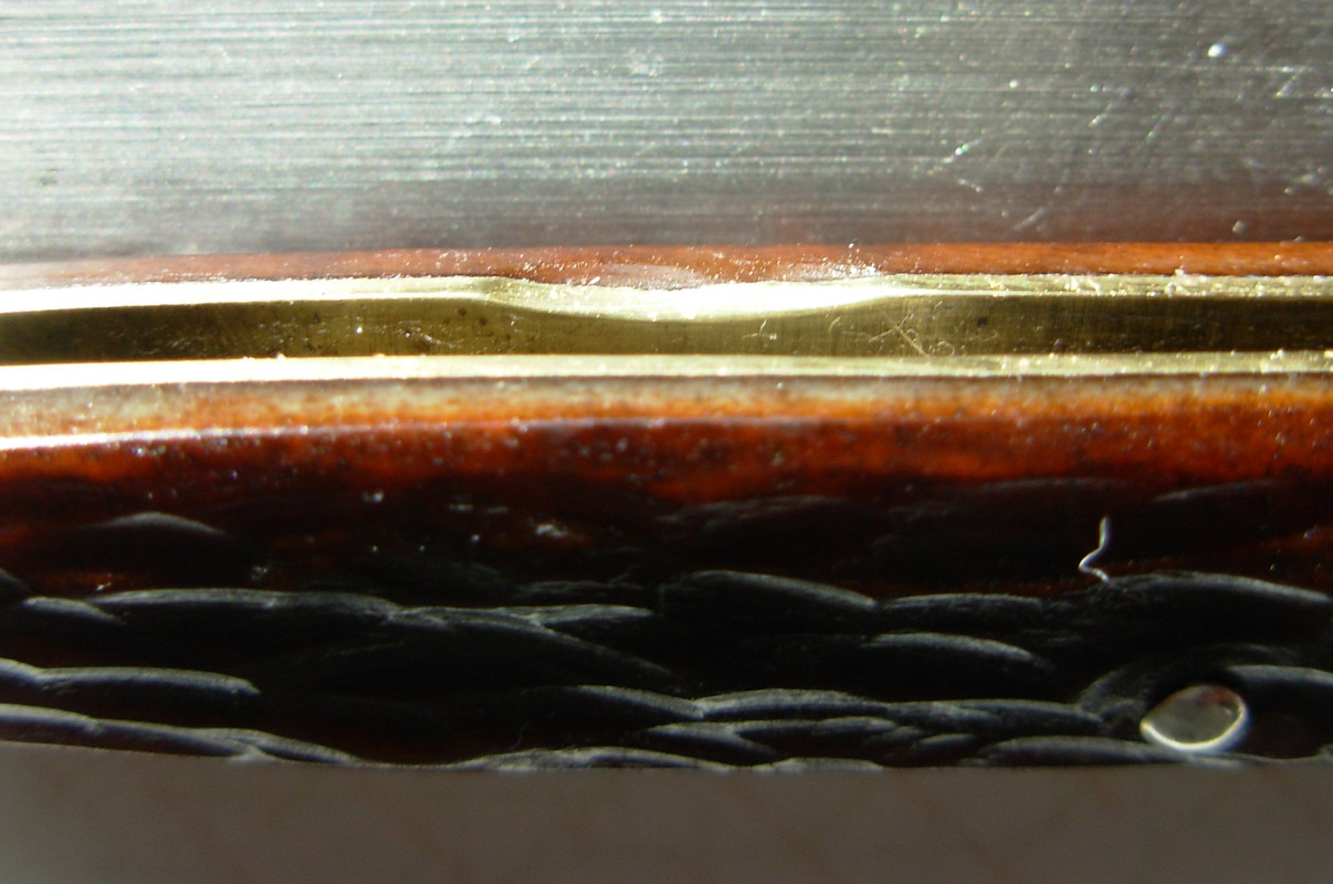

As most know I like small pen knives and while my GEC's are easy to get to the nail nick and open some of the older knives with sunken joints are not. The John Primble I got recently was one of those and it was hard to get the smaller blade open with my short thumbnail. Then I remembered the little Winchester I used to have. The Winchester had a little angled semicirculer cut that allowed the pen blade to be accessed easily.
The Winchester
So I thought why not try that with a Dremel. My result is not as nicely done as the Winchester but the result speaks for itself as I can easily access the nail nick and open it now.
The Winchester
Those subtle cut-outs are very common on old Sheffield Penknives. You did a great job my friend, well done :) That little Winchester looks familiar :) Thanks buddy :thumbsup:

I've did an angled cut on a couple Barlows, about 2 decades ago, to access the pen blade nail nick. I forget what brand(s) they were. (Sorry. No pictures.)
It is tempting to make a small angle cut on a couple RR pen blade spines to make the primary's nick more accessable.

I think they are a throwback to a different more elegant time. When the Winchester was made it was probably second nature to add the cut to make it easier for the user. Later it was likely the victom m of cost cutting figuring most users would never think about it or complain.
The Case-Bose Norfolk has that notch. No way would you be able to open the clip secondary without it.
Your mod looks pretty well done to me!

The blades sit low in those old Penknives, and the feature is subtle, effective, and doesn't spoil the lines of the knife :thumbsup:
That cutout for the nail nick is not at all uncommon. You will see it quite often on modified Opjnels.

As Gary noted, CASE/Bose Norfolk has it for the minor Clip blade-and it's needed as it's a strong spring. CASE also have one on their Humpback Stockman which is a clever knife with near sunk-joints and on the 2 spring Half-Whittlers I believe, also the small 90 model Stockman. GEC's 62 pattern as well.
