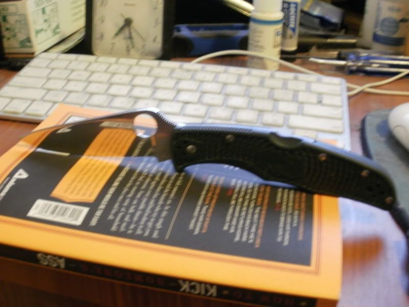

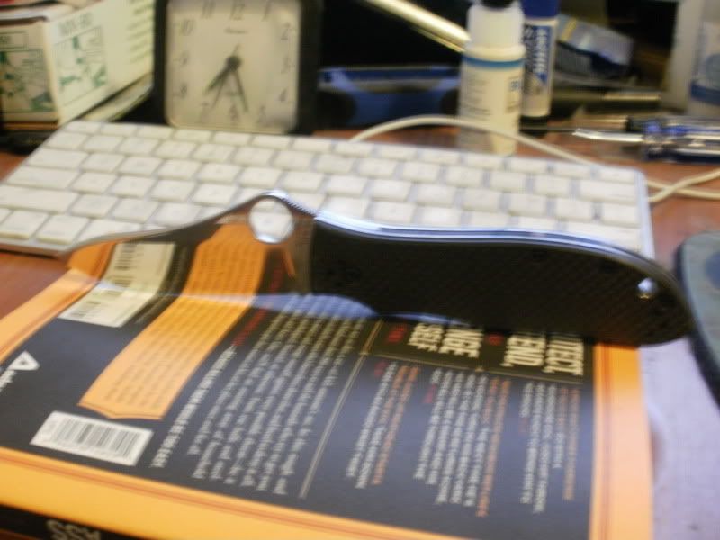

Endura 4 "Kreined" FFG in ZDP-189.
Spyderco Gayle Bradley in CPM-M4.
