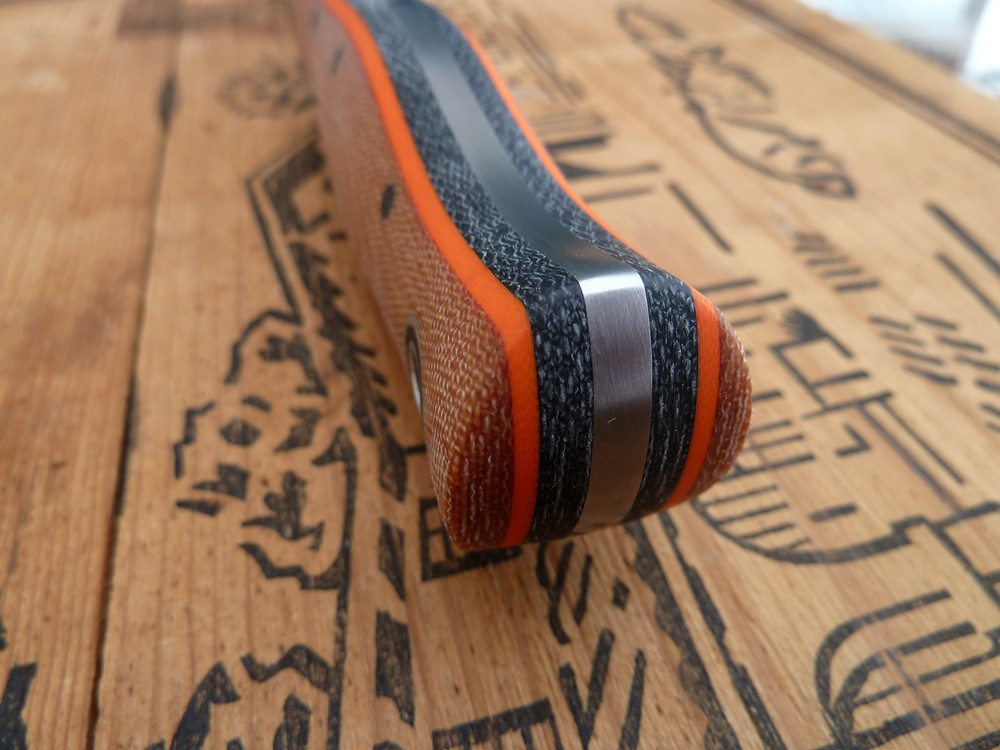

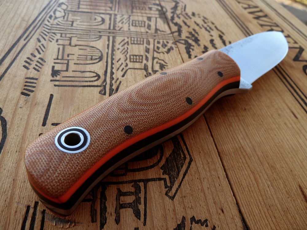

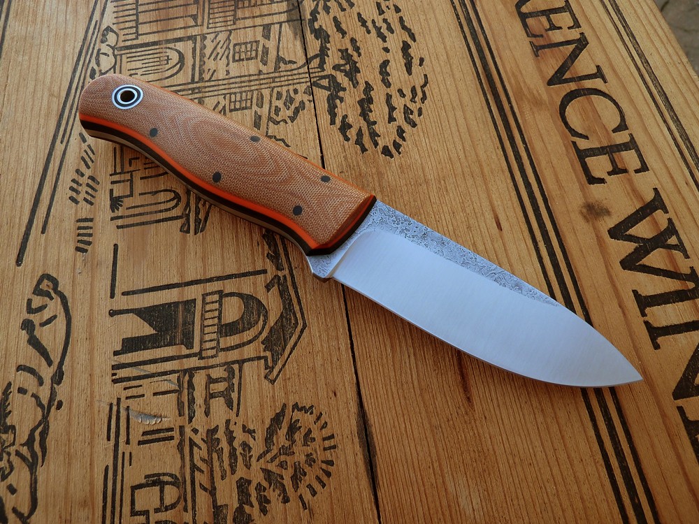

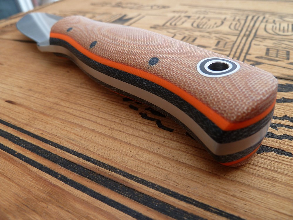

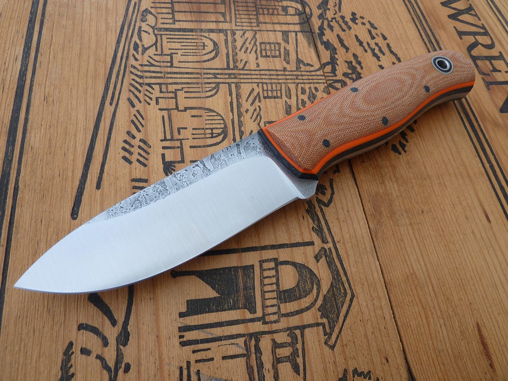

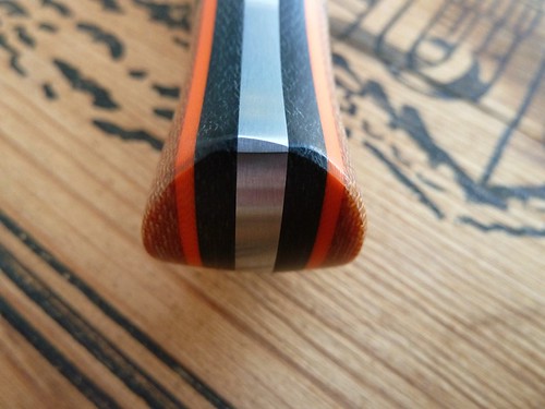

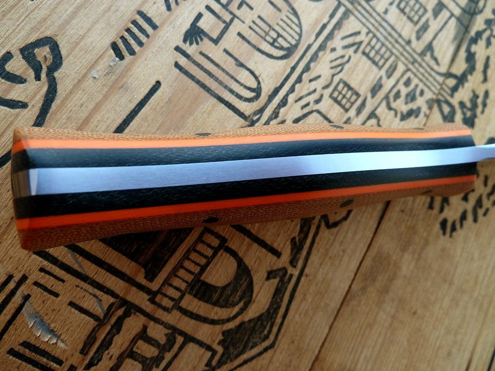

I have never been fond of polished handles, and I had heard it's not too hard to give them a nice grippy matte finished with different levels of 3M scour pads. So, I went out this past weekend and bought a few different grits, taped up the blade nicely, and gave it a shot. A few hours of work later, and I am happy as a clam!
I now have a nice grippy Fiddleback Bushcrafter dry or wet (especially wet), and it just feels better in the hand.
I tried to take a few before/after shots, but with this type of micarta it was a little difficult to truly capture the difference with a camera. In person, it looks and feels much different and is a huge improvement in my opinion.
For anyone who is like me and prefers matte over high polish - what are you waiting for??
The 'Before' Shots (Polished)

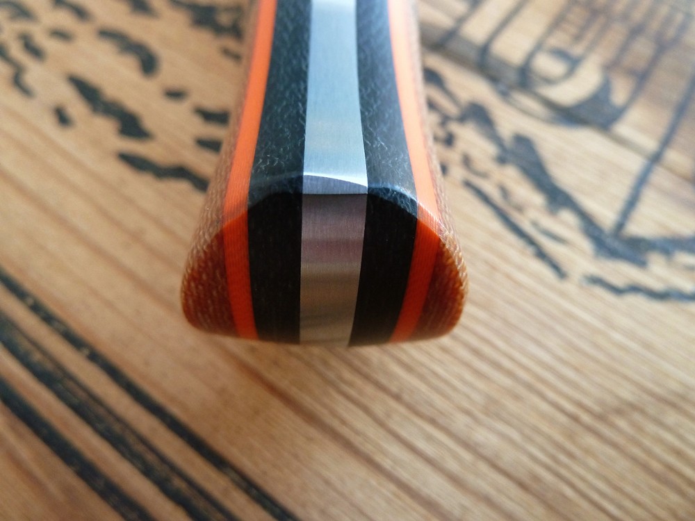

(apparently a little snafu with the grinder - I was able to smooth it out for the most part)

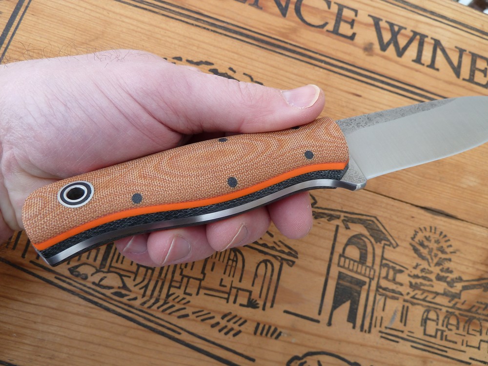

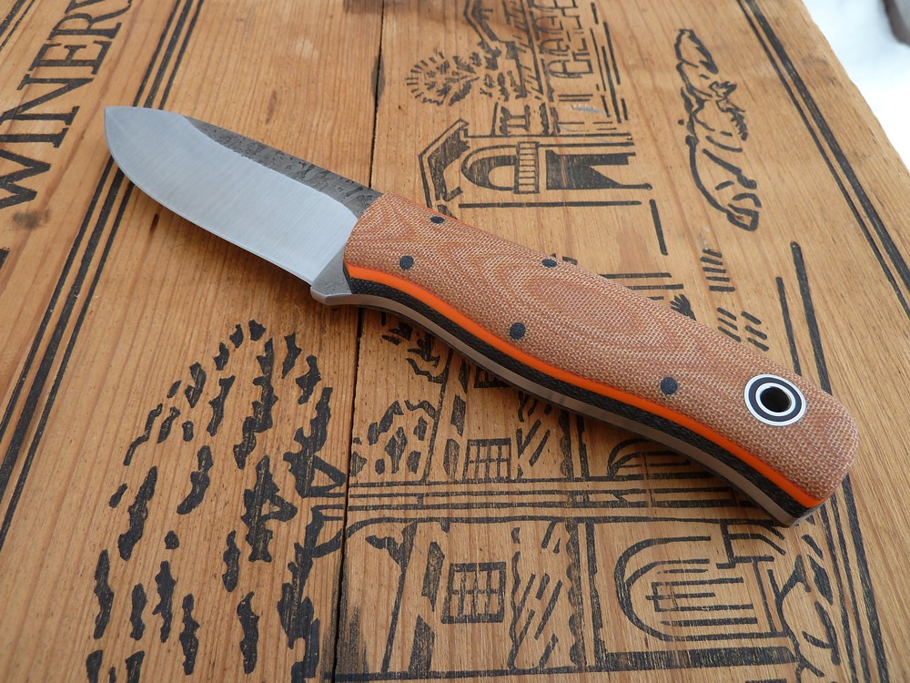

The 'After' Shots (Matte)
Comparison of the fix on the butt of the knife (turned out pretty well if I do say so myself :))

Looks good, especially the clean up of the "oops" on the butt of the knife. What belt (grit) did you end up with to fix the "oops?"
Also, what grit of scour pads did you start and end with on the grip "de-shining?"

Sure - I used 150 grit sandpaper folded a couple of times (to make it stiff) to fix the "oops". After I got it to where I wanted it, then I used the 3M pads to matte the handle as well as finish the butt of the knife.
To put the matte finish on, I started with the #2 pad (very coarse - dark gray color) over the entire handle a few times, rinsing several times under hot water to free wax and debris. Then, I finished with the #0 pads (semi-fine - dark green color) over the handle a couple more times (lightly) to put on a consistent looking/feeling finish.
Then, I put tape down on the micarta on both sides of the spine, and cleaned up the spine with very straight strokes to give it back it's stock brushed finish, and get rid of any swirls.
It worked great, and didn't take all that long. I'd say the butt fix took me about 90 minutes, and the matte handle job took me about 30. It was well worth the time, and now it feels even more like it's "mine".

Cool. That snafu looks terrible though. I'm quite embarassed about it. The point of doing that is just to break the point of the handle there a bit so it doesn't dig into the hand.

Please don't be embarassed about it! In the grand scheme of an awesome blade, it was a tiny flaw. I was pretty proud of my little fix job, so I had to crop in close to be able to see the before and after. It most definitely was not this noticeable in person.
This knife is amazing in every way that counts, and you have to love a knife that has some of these tiny flaws because you know it wasn't made on a machine. These are truly handmade knives, and those things will happen from time to time. I actually like that I was able to do the little fix and matte the handle. I was able to spend a little time making it "mine".

Thanks - I love it. My Fiddleback camp knife has the same combo - black/orange liners with natural handle, but the micara on that one is shadetree burlap instead of canvas like this one. One of my favorite combos.
