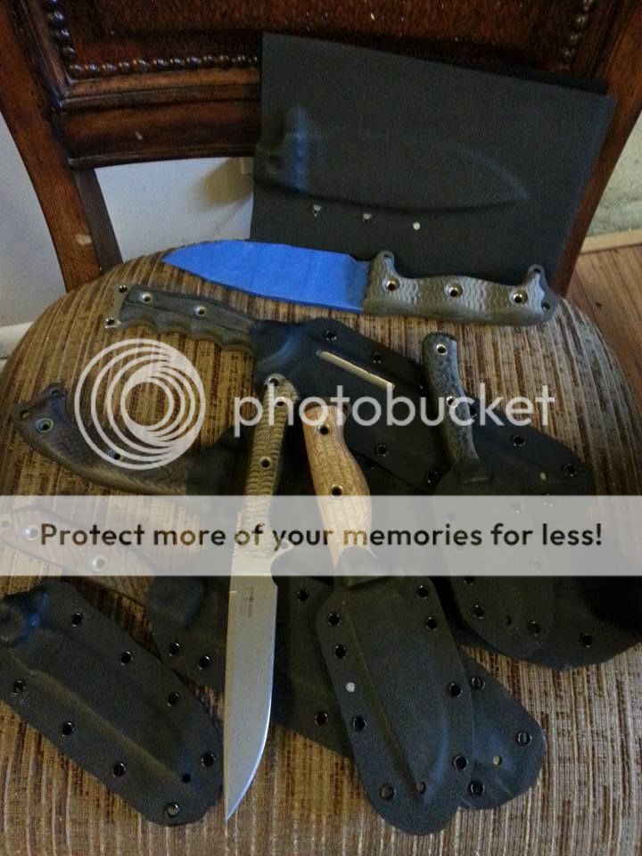

I made this taco style for my AMS, not because I needed it per se,, but for practice, as I am making some knives as gifts for Christmas this year.
I did my homework, and with a few practice runs, got some great retention.
It doesn't look like it has great definition,, not sure if thats a result of the .08 thick kydex or what..probably I need some better foam.
:thumbup:
Making the clip was pretty easy too, and had a few Chicago screws lying around.
Kind of fudged up that part, where the bottom of the clip is bent out from the rivets on the sheath.
The tricky part, is raising the thumb ramp here.
A lot of the retention is coming from the kydex molded into the rivet hole on the scale, (shown in blue circle), so in order to maintain that and heat this section enough, I would need to submerge the sheath in cold water, and hit that very small section( above the red line) with a heat gun.
I don’t have a heat gun yet, but will pick one up and see how it goes.

Oh I definately don't have any equipment that nice!
I picked up a foam press for 75 off eBay, although should have just made my own.
For the rivets I use the hand setter/hammer. I break about 2/10 rivets,, but getting better.
Other than that I just use my belt sander, hand drill, and a standard oven to heat. I use the same laser thermometer I use at work, and that made a big improvement on the fit.
I did a lot of research about what temp to use it at,, and how slow to heat it,, other than that its a LOT of trial and error,, mostly error

Heres a few I made the other day. (I ran out of the correct rivets on the ASH-- and I haven't cleaned them up to look pretty yet either)
These are all made from .08 thick kydex.
Whoa!! Nice work man! I may have to bug you for some tips,, you even cut out the fuller on that mofo crusader(?)
Thanks, they work lol. Yours is looking good too.
I've only been doing it a few weeks, I've only made about 15ish sheaths total (what I could get out of the materials I ordered).
But I made 2-3 taco style, and yea they are way more of a pain. I haven't tried anymore cause my $15 heat gun broke, and like you said it'd be hard to fix specific parts and make that little thumb ramp without a heat gun.
I just use a homemade press, a regular drill for the holes, and a dremel for cutting, but I did splurge on a rivet press (I knew the hammer type ones would be a pain so I just went ahead and got a press).
I use a little toaster oven on the small ones that will fit, but a regular oven for anything over 5" blade or so. No thermometer, I just do it by feeling.
Yea I cut the fuller section out of that lol- I didn't plan to, I accidentally didn't pad the fuller enough so the kydex sunk in a little (it wasn't much, just made it a little tight) so I thought it would look cool with that cut out so I did.

I've made most of my own for a few years, to get that top molded out a little just use a bic lighter and hold the flame on the inside then bend it out with your thumb to where you want it. I defiantly recommend the rivet press that sure makes it easy.
