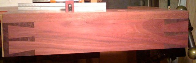

Here is a similar chisel. This one goes for around $500. One of my prize possessions. I have used it very hard in super hard purple heart wood. With great care though and a full understanding of it's capabilities AND LIMITATIONS.
Love this thing.
It pared these giant dove tails which are three inches long. That is a twelve inch ruler standing on edge on top the work bench in the third photo. Most drawer making dove tails are a half inch or so. But now I'm just showing off.
PS: no chipping or problems with careful tuning of the edge angle for the hardness of the wood I was working.
PPS: the last photo shows a test joint for a similar project. Cut and pared to fit perfectly but not glued up. This paring chisel is driven by driving it with two hands and a shoulder by body weight and muscle power but not hammered. Those chisels are not too hard. I could use one even harder and they do make them. Fun stuff. (ignore the metal thing in the last photo)
