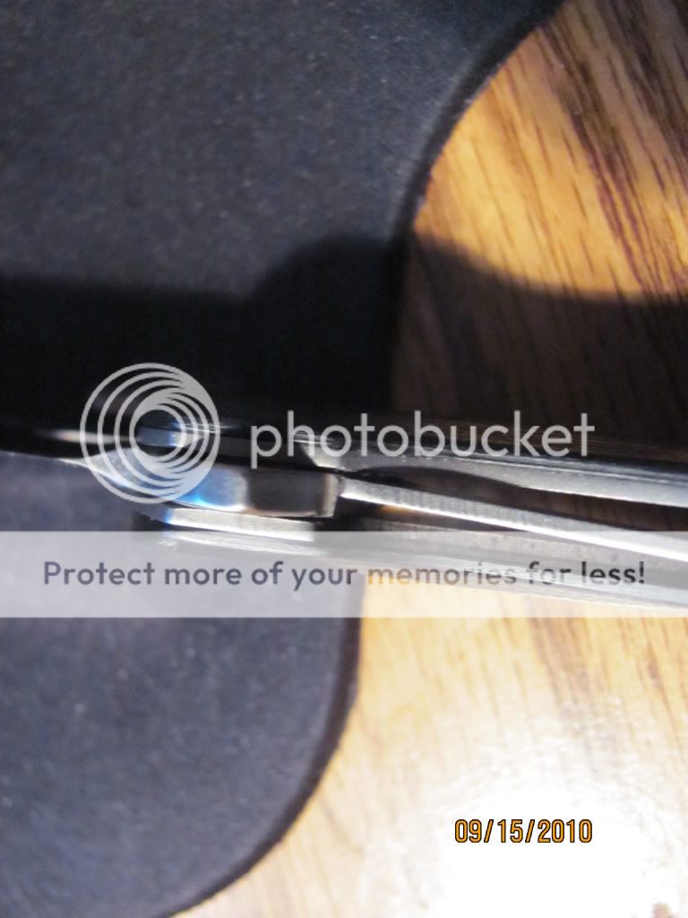

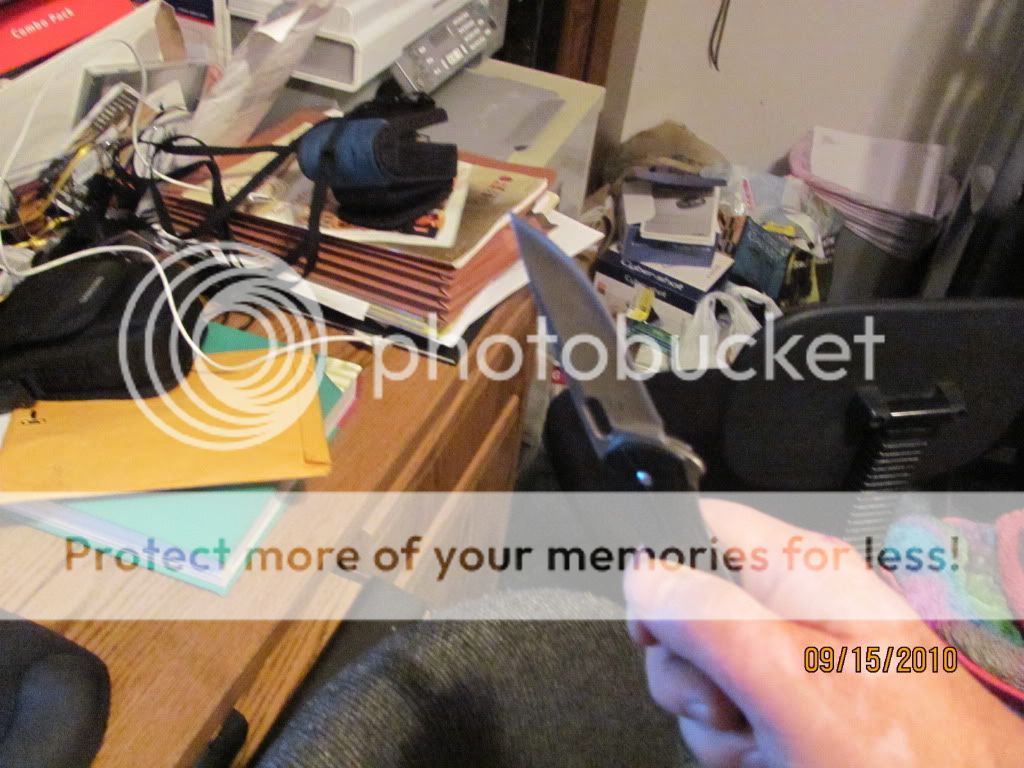

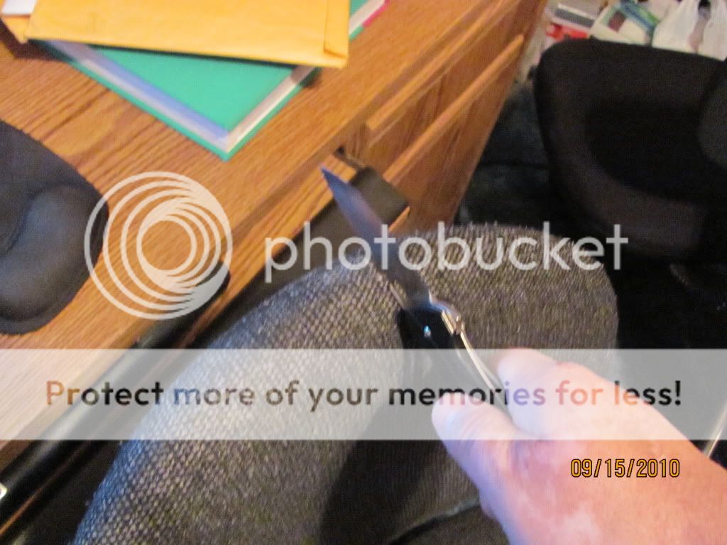

Well found draftpicks experience to be very surprising and Mr Keys' answer to be very reasonable. But since I have a couple, I thought I'd try it on my own. I used my computer desk chair as my anvil.
I started whacking the spine of my 347 Pro from about 7 inches away.

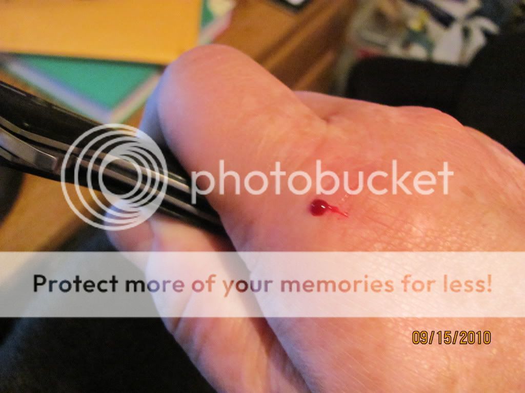

I figger if I was pounding a 10 penny nail, I was using enough force to drive it into a 2x4 with around 6-7 whacks(just a reasonable guess on that). On whack 15, the blade closed and caused this.
about a 3/8" slice.

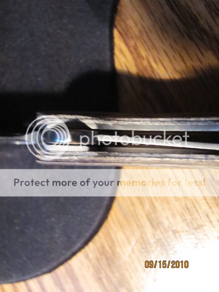

the blade locks like this-rt side lockup
I used the same test(basically) with a 345 select oiled blue dymondwood and struck it over 3 times without failure. Granted I may have been a little easier and held it differently cause I didnt want to get cut again. I did my best to use the same force and think I did, but who knows--I aint mythbusters:p.
The 345 locks up dead center
and the linerlock is noticably more stiff.
