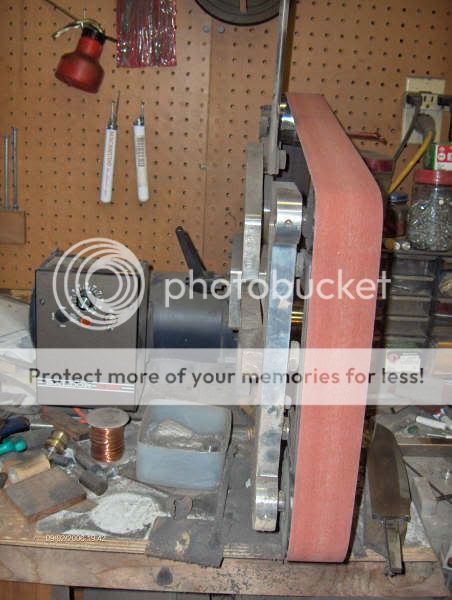

That is the grinder I have been using for the last year and and a half. Leeson motor, Baldor speed control and Bader wheels. No problems and no complaints. I did put a plate of hardened 01 on the platten but that is the only mod it has needed. Both times I tried to stall it out I destroyed the belts. It has plenty of horse power.
The grinder has been changed a bit from the picture on Al's website. The idler pulley is now aluminum and the drive pulley is crowned a bit. The tensioning lever is much bigger now for more leverage. The on/off switch is now on the speed control and not seperate like the pics shows.
I did have to make a 220vt extension cord/adaptor for it but that was easy. When you go to hoist it out of the crate you will see it has more then enough beef to it. $1400 delivered and ready to work out of the box.
