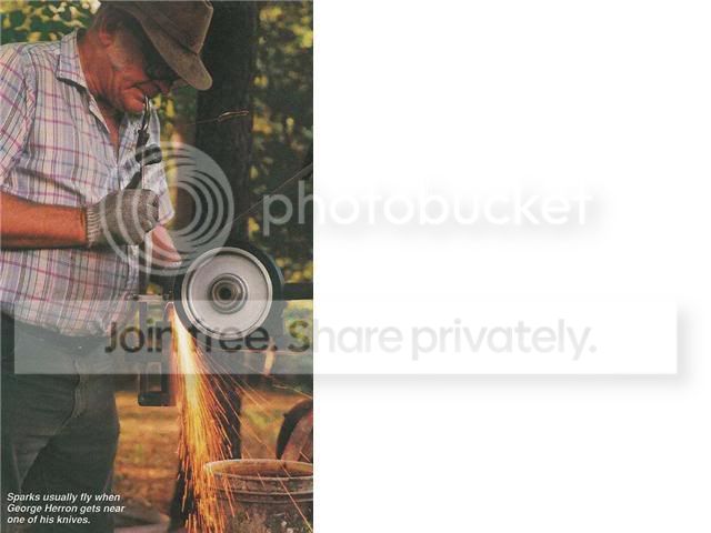

I was looking at Josh Smith's website tonight and in a Blade '98 article he had on his site, there was a picture of George Herron grinding a knife. It looks as though George is using some sort of attachment on his grinder to add pressure or perhaps guide the blade while grinding. I was wondering if anyone here had seen George grind a knife with this setup and could explain the mechanism a bit?

Don't know much about Mr. Herron, but I'd agree with your assessment that the attachment is a nifty way to add consistent pressure, similar to a push stick.
--nathan
George Herron plays a significant part in American custom knifemaking history. From South Carolina if I remember correctly, he was well known for the exquisitely crafted and designed stock removal using knives he made for a long, long time.
Somewhat of a creative chap, you are seeing a combo adjustable work rest and push stick on steroids. I believe there is a roller for the backside of the blade to move smoothly. Another one of the devices credited to his name is the Bader 3 grinder, and that glorious idea of a square toolarm so prevalent in shops today.

the device that George used was of his own creation. i believe that Geno Denning uses the same device and that it is built with discarded motorcycle parts. I believe I have the plans and pictures of the parts somewhere and I will look for them and post them if located. He was a great man and when he took Geno under his wing he knew that his style of knifemaking would live on long after he passed.

That device is known as the Herron Hog. I built a Bader lll with Mr. Herron's help before it was a Bader lll. One of my grinders is a prototype. The Herron hog was produced by Sharkey Tipps for a very short time. It was designed mainly for removing lot's of metal very quickly prior to heat treat. It was not considered a grinding jig, but as a tool to hold pressure against the blade to speed up the rough grinding process. I have one that I built but seldom use it. It works best for a simple drop point. It does take a lot of expertise to hold the blade straight while grinding. He could actually finish a blade and have it ready for the buffer using it. Very few people have the grinding skills to be able to pull that off.

Bobby, since you actually have a Herron Hog, could you perhaps post a few pictures of it? In the pic that I posted, the grinding sparks obscure it and doesn't really show it off well enough to make one.

Thank you for posting that Jay, I really enjoyed watching the videos (all worked fine) and looking at all the knives. Video #5 has a great section of Mr. Herron using the Herron Hog and I could see quite clearly how it works.
