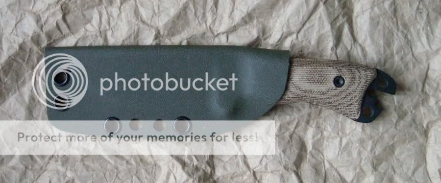

Here's a quick update. Nice coincidence that this thread landed within a day of reprofiling my BK11. It's been collecting dust in the bottom of my gear bag waiting for a sheath that won't dull up the blade. Just rec'd a very nice Kydex sheath from Marion Poff - this exact one:
http://i496.photobucket.com/albums/rr327/mdpoff/sheath-1p-necker_eskabar-od.jpg
Perfect fit and very good price. More pics to follow on the Becker forum as time allows.
Anyway, this is presumably the same steel as the BK2 - 1095 Crovan. Ground it on a Smith's coarse diamond stone, stropped on 220 grit SiC powder and finished with a dozen swipes on some green CrO. Not only push cuts newspaper, but managed to (with a bit of tugging) dry shave two day's worth of whiskers from my cheek. While this steel (and regular 1095) does work very well as a coarse edge, my ongoing experience continues to suggest it doesn't have a real preference and should take a screaming fine edge. Best of luck with your project and let us know what you find out. This is my only knife in 1095 Crovan, but the edge I usually go with on my other 1095 knives is fairly coarse and stropped on black compound. Holds that edge very well. Too coarse or too fine (below 200 grit or higher than 2000) and they don't hold up as well but that could be said for many steels and might just be me...
