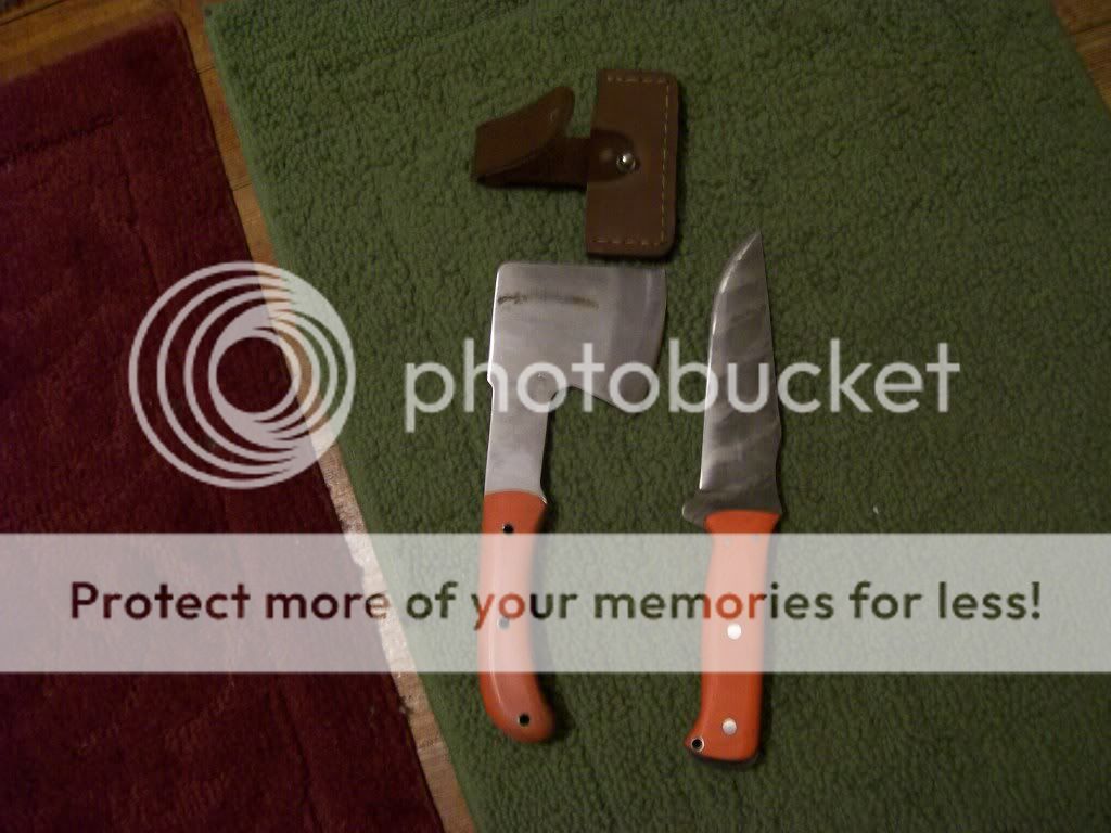

Yep every day it is part of my EDC. Here is one that I made.
I just love little hatchets.

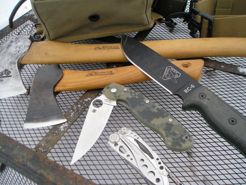

I certainly love the mini wetterlings, great little tool to work with. On a day hike I usually dont take it, the RC6 comes along.

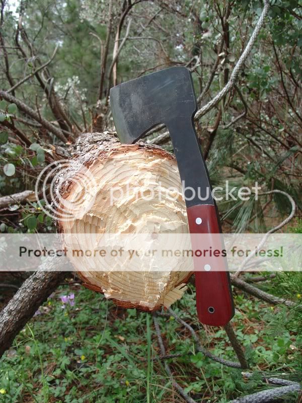

Russamuri, I tend to scale the wood to the size of the hatchet :)

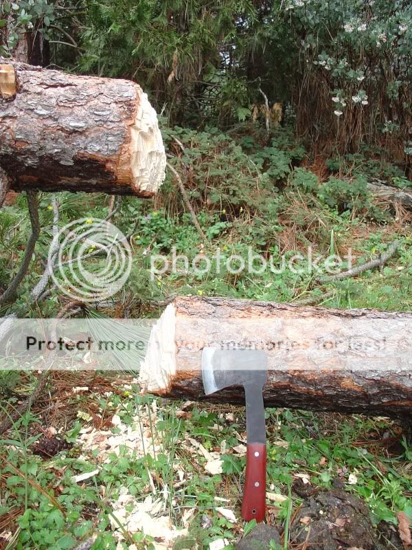

In my photo the wood was cut with a lightweight folding saw.
I stood the cut pieces on a flat surface (available stump), held it in place with another piece of wood NOT my hand.
Tapped the hatchet into the piece to be split just hard enough to stick it.
Then lifted the hatchet and wood together and tap-tap-tapped it thru.
I guess you could whomp it real hard and get thru in one hit, but I was taught to never use brute force when using sharp tools.
Pop always said "let the tool do the work"
YMMV, but it works for me :)
Small sharp Axe and large folder (Spyderco Millie) will do almost anything I need in the woods. My axes are from Wetterlings and a bit larger than the GB Mini.
If I'm only carrying a knife it will usually be a ~4" fixed blade (Northstar, Bravo, Canadian Special, Aurora or Helle)
