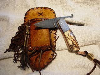

Thanks all! Mitch is right, Dave is a class act and a good friend of mine.In fact the weathered oak friction folder I posted belongs to Dave. We did a knife swap earlier in the year and that one was my offering to him. Yeah, I'm surprised to Lycosa!
Yes Dave is a GREAT!!! guy. He has donated time,knowledge and materials to me for the sole reason of helping me learn to make knives.
The FF you swapped to him an the sheath are AWESOME. I feel privilaged to have groped it :eek:

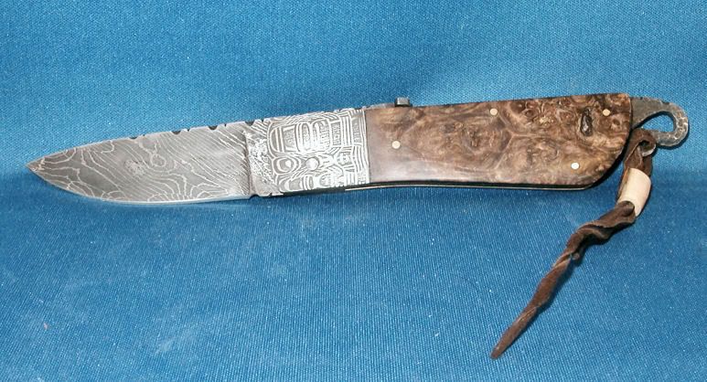

Here you go.The first pics are a matched pair I made for a customer in Ohio.As you can probably tell, I like and use a lot of weathered oak, as do my customers!
More nice 1's John.
What's the burl on the last 1? has a bit of character to it.

Wow, thanks for all the nice words guys. And Yes I have one of John's folders as they are top notch as is he.Here's a few of mine, a bit more contemporary than John's.Dave:D
Hey Dave, glad you put a few of yours in here! Make no mistake, your folders are awesome too.Actually yours are probably more traditional than mine, with yours being of slotted construction.
