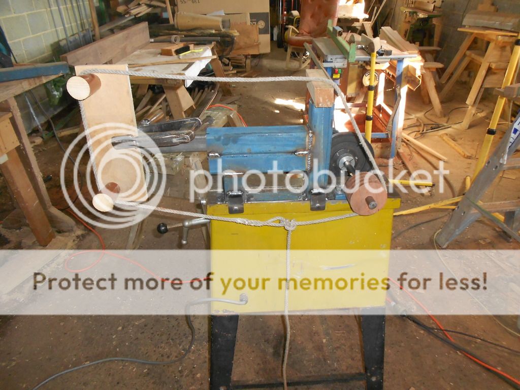

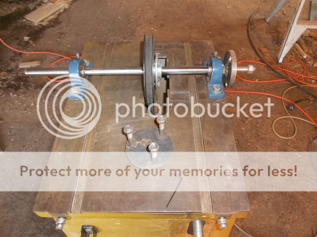

I used an old saw bench as the base to make mine from
After a good look in my shed I found some 2x2 box steel that would work for the main stands and with trip to the garrage for some welding was able to do a mock-up . A length of cord tied off at 72 inches gave me an idea of finished composition
