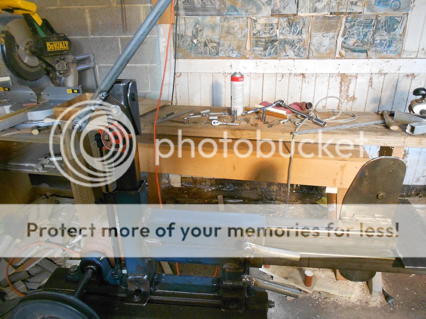

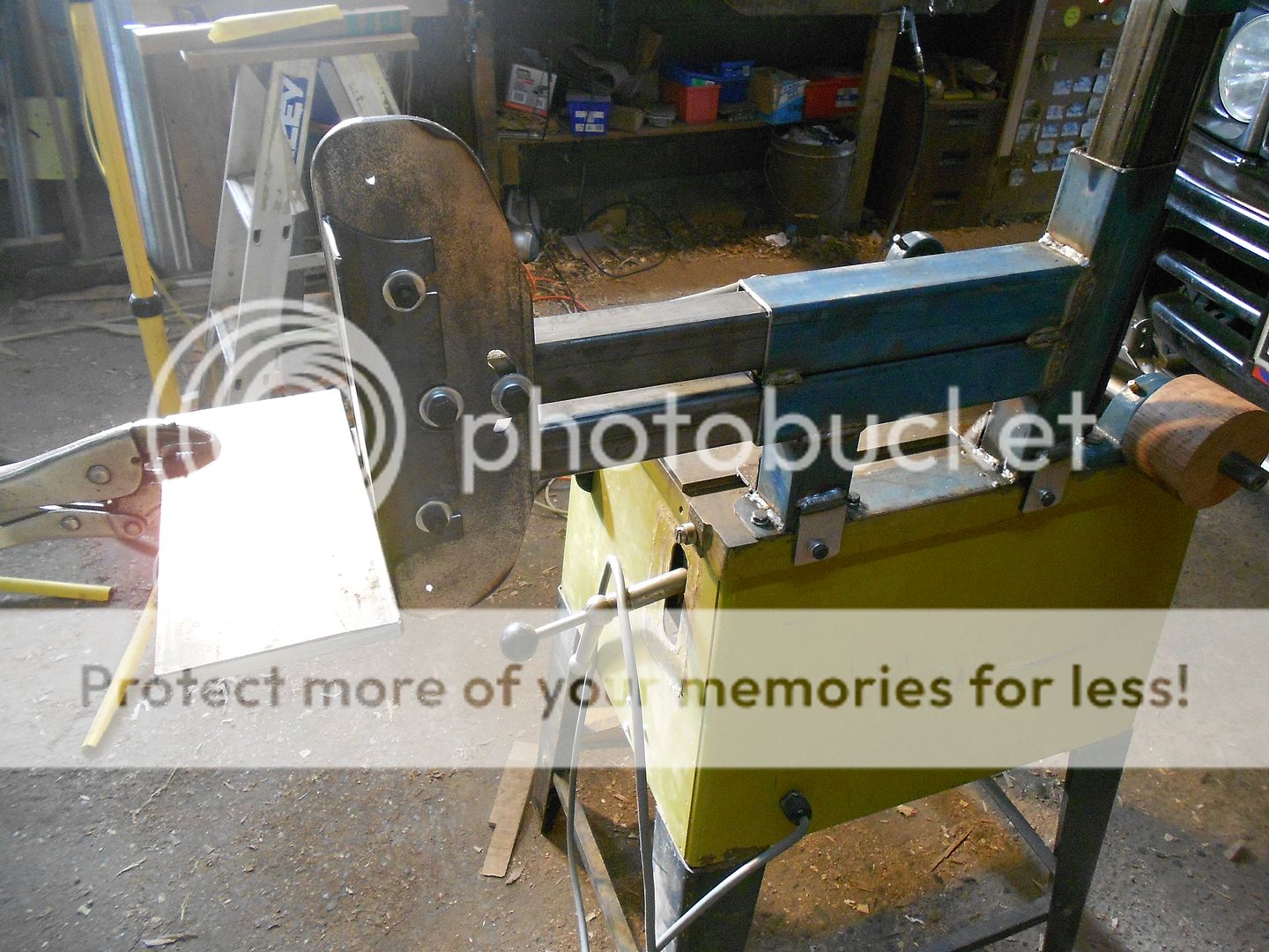

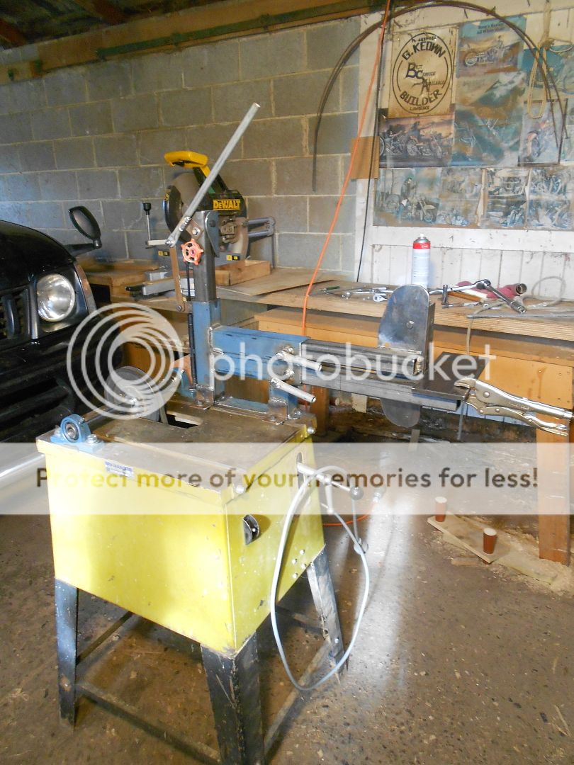

Been a busy day and have it all to a stage now that it just needs the drive wheel turned and the wheels to arrive from the US so in a couple of weeks I should be able to get it tunred on. The tool rest will not get welded on till the wheels arrive so I can center the rest against the belt
This is how it sits for now though.
I will drill out the holes for the idler wheels when they arrive

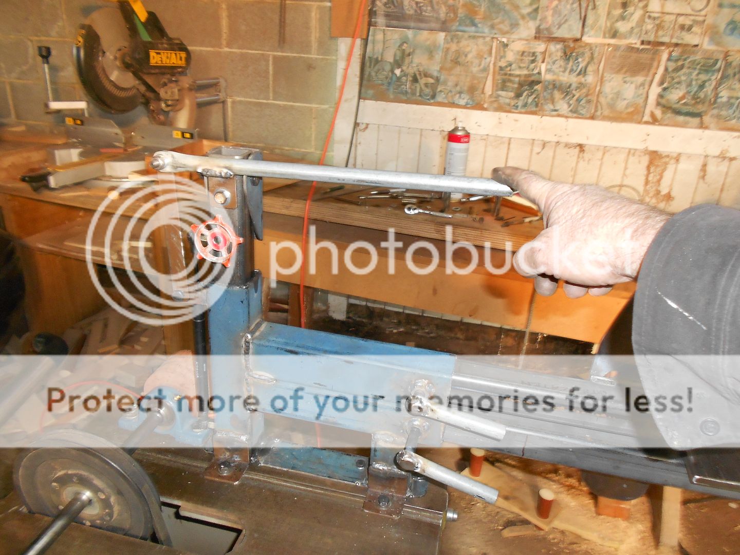

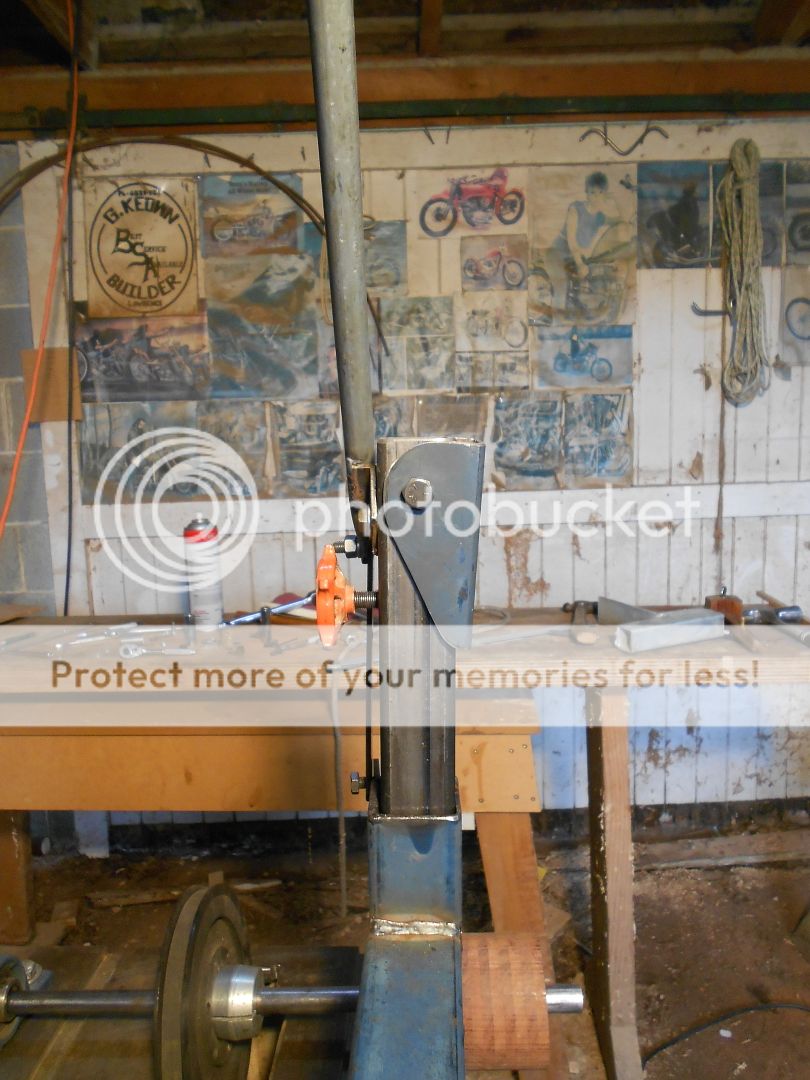

The handle of an old gate valve made for a good tracking adjuster wheel and a length of pipe flatened and welded to the bolt head will allow for tightening up on the two sliding tool heads.
Here I am holding the tensioner down against the gas ram stroke

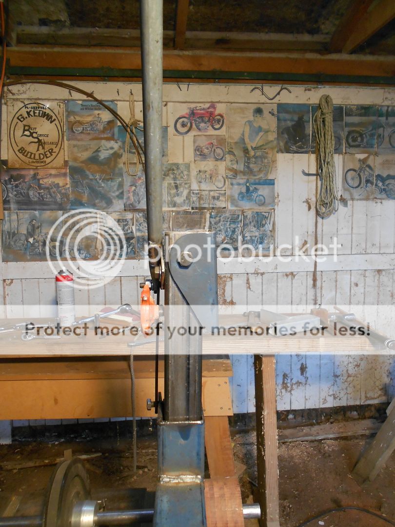

With it released it shows I have a goodly amount of travel
Then there is the tracking aduster screwed all the way out to track one way
And all the way in to track the other
@Von Gruff: I saw your thread on this grinder over on castboolits forum - looks good. I've always had concerns about how to press the spring down, but I see the handle you've got to give leverage. Good idea! I like it. That design sure takes care of any flex in the tension arm. Where I to build another grinder I think I'd look seriously at this design using your leverage arm to press spring down for belt changing.
Ken H>
I guess I got the idea for the handle from the leverage system on my Lyman 4500 Luber.
