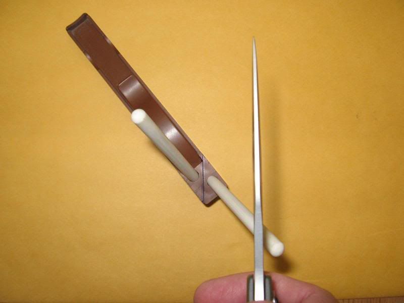

Even though it isn't adjustable per se, there are several ways to get different sharpening angles. One is just to hold the knife a little off verticle to make the sharpening angle greater or smaller as needed. Another is to prop one end of the Crock Stick base on something, sharpen that side, then prop up the other side and sharpen. However what I like to do to get a more acute angle is just rotate the base as needed:
Notice the black line I've added on the base, between the two sharpening rods ... this gives me a sharpening angle of about 17 degrees/side, which is what I prefer on many of my knives. Just keep the knife parallel to that line while sharpening, as shown.
