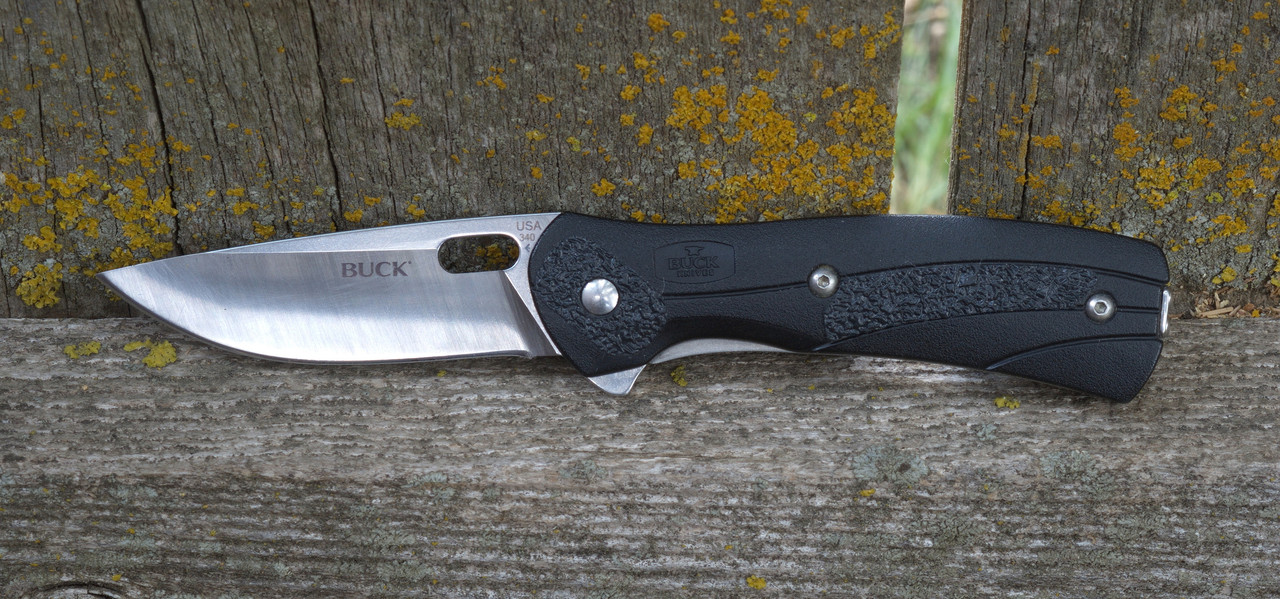

I used an electric file (tiny belt sander) to add flats to the 119, and a quick checkering job with a chainsaw file. Repolished grip to a matte finish, much happier.
The 117 got a similar treatment. I used a lower grit belt and did the whole grip. Slimmed it down, and left the rough texture. Came out pretty good.

I like that 117! I might try something like that! any tips on how you got it to turn out like that. it looks intentional and not just all randomly scratched up. did you go around it - like twisting the knife inside the sandpaper?

It really does look good and in the pic it looks similar to a carbon fiber material. I’m advocating for this method over any coating! Excellent work on those H HolyRoller !

So what I did was take an electric file (like I said before, it's literally just a tiny, handheld belt sander and it might be one of the best tools I've ever bought) to it.
So for starters, I slimmed down the sides to give more front-to-back definition. The stock grips are as wide as they are thick. Fills the hand nicely, but I like having more ability to align the edge by feel, alone.
Once I achieved the shape I liked, I realized the heavy grit (probably 60 or 80, the little belts sometimes aren't well marked) left a decent texture. I put the tool into my vise, knife in hand, and ran the grip over the belt lightly to hit all the phenolic surface. I kept the grip perpendicular to the belt to maintain the "grain" of the texture. It's definitely more grippy, yet not rough on the hands.
I was going to replicate the hatching on the 119, but the 117 has much less surface area to work with so this was more like a happy accident.
