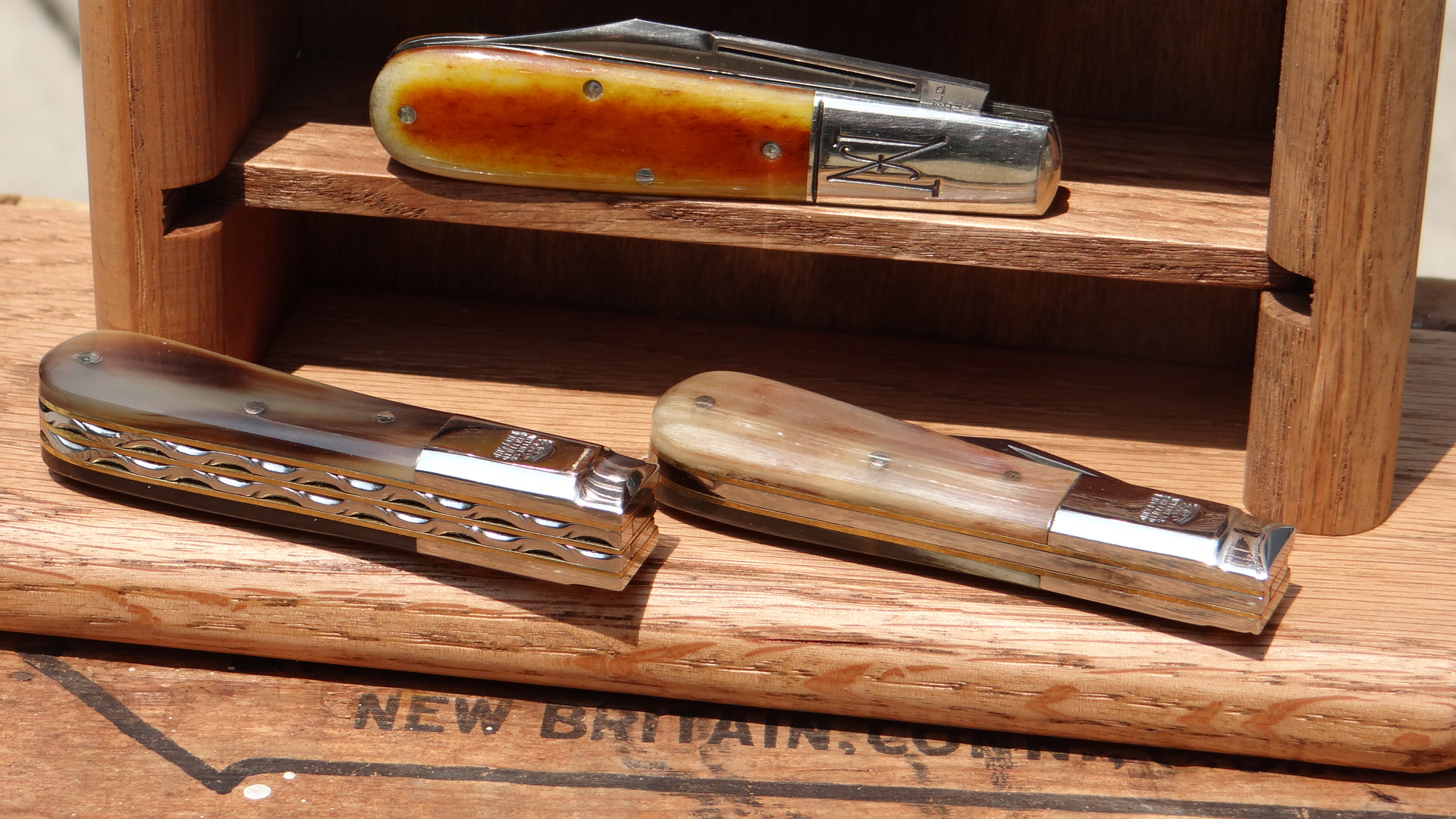

Taylors Eye Witness Barlows are 2 on the right . Gec 73 on the left .
Edited to add : Action is pretty stiff because of the square ends of the blades . Desirability of that is certainly up for debate .

For comparison the one on the right is a flush and square joint, left is a flush joint. Both of these are Sheffield knives, strong pulls and hard snaps but of course other Sheffield knives without a flush joint have the strong pulls and hard snaps, I can't tell a difference in the actions.

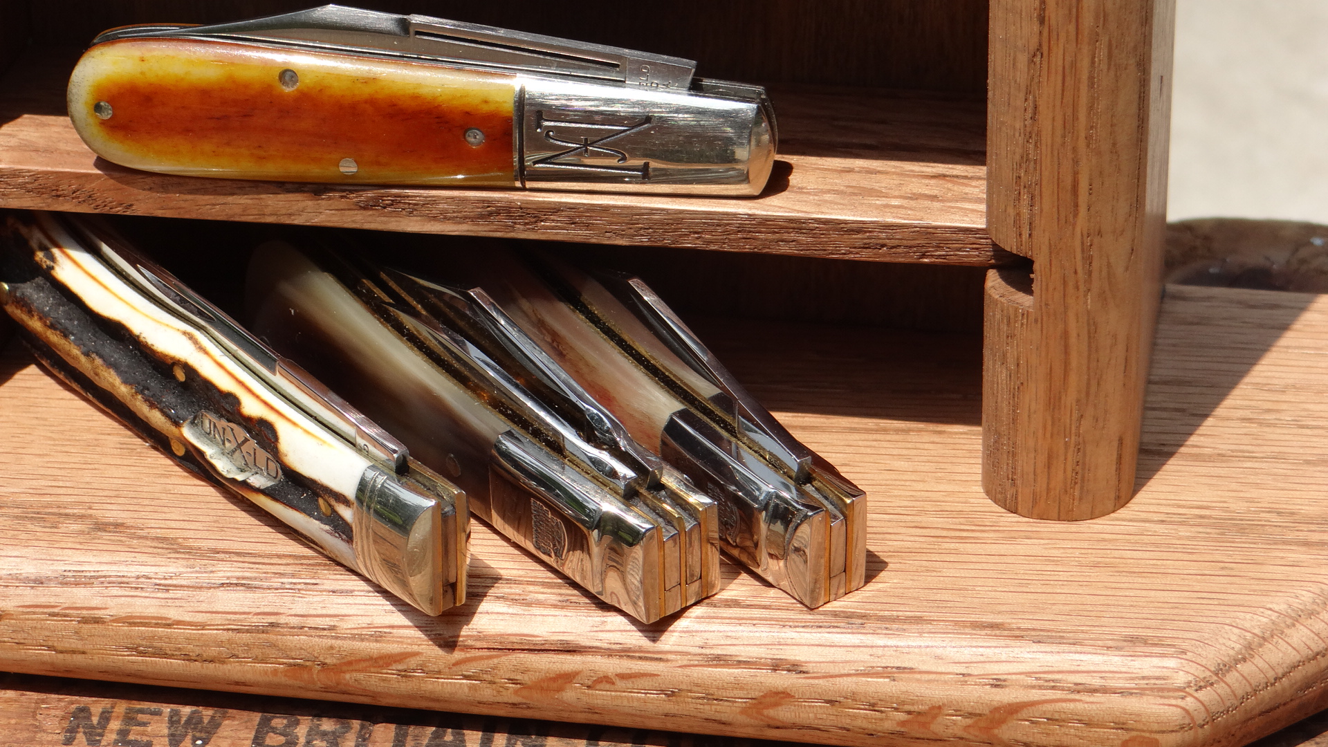

Old knives ROCK! They were made to be used not to win any dang contests! The flush joints on the knives in the 3rd image are SCARY FLUSH! This is the kind of thing that truely inspires a great knifemaker.
That knife on the left is awesome! The bolsters, liners, blade, and spring are all flush. On my #73, the spring falls just short. It boggles the mind that the knife above was made by a man who was paid less than minimum wage (when adjusted for inflation). Especially when you consider that there are very few makers working today who can make a knife to the same high standard.
