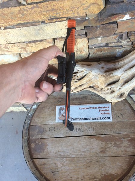

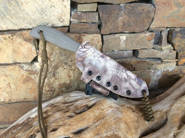

After searching around and not finding a pattern I like, I'm going to try my hand at making my own. It really doesn't seem that hard. All I need is a $5 6mm rivet setter, some kydex, and some rivets. Already have the padding for the press, toaster oven, and cutting tools.
The way I look at it, I already make my own booze and powder coat my own cast bullets....so screwing around with kydex definitely seems doable.
I ordered 6 so I will make at least that many!
Both of these have the Tek Lok mounted in the modified scout position for right hand cross draw. I do like this position on my strong side too.
Both have one of my emergency fire steels, a Fire Cord 7rattlesbushcraft tie and paracord lanyard.
The Black Basket Weave sheath has an orange liner.

Any kydex sheath designs that would bring the pommel at or below the belt-line? Seems like they all leave the hilt at the belt-line. Thanks
IMG_5824.JPG IMG_6601.JPG IMG_6600.JPG There are various attachments that will do that like a dangler attachment or a dropped Kydex piece with a Tek Lok or metal belt clip.
