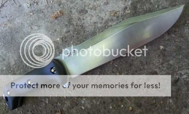

I stripped mine just yesterday. And the moment I finished I realized I may have ruined that wonderful sheath I got from BaldingEagle a few months back, recalling that The Warrior's BK2 did not fit in the passaround sheath as well as the others'. So I ran upstairs and slipped it in and out of the sheath. It's looser, but this is actually in a good way. There is still retention, and now I can take the knife out without actually struggling with it. It's still satisfyingly snug in there, although the retention strap will come in handy now.
The patina could have come out a bit better, but that was out of function, not fashion.
The shiny can't be argued with!
