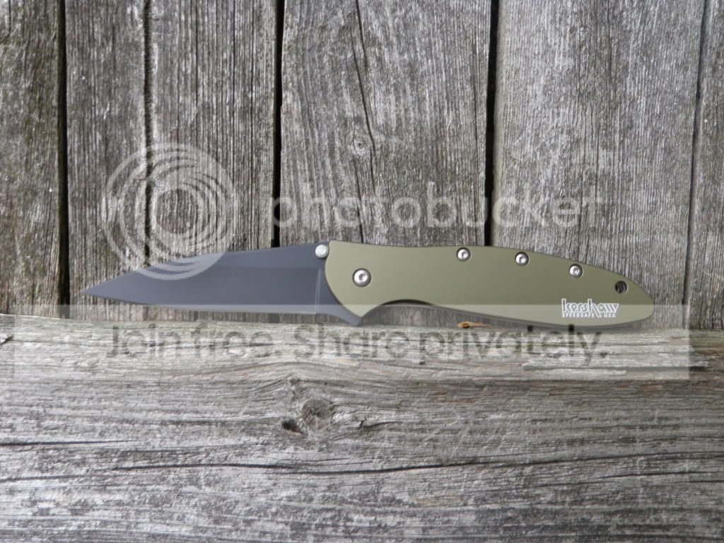

I have a leek, and I don't think that model is well suited to be manual, I like the Assisted opening on it, just my thoughts

will the Leek have blade retention issues if I disable AO on it?? TBH I love the design of the knife, blade shape is great, handle is comfortable for a smaller/gentleman's type knife. But I just don't like the AO. For one thing the stainless handles don't give a positive feel when opening and closing, and overcoming the initial torsion of the AO.
