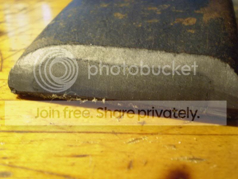

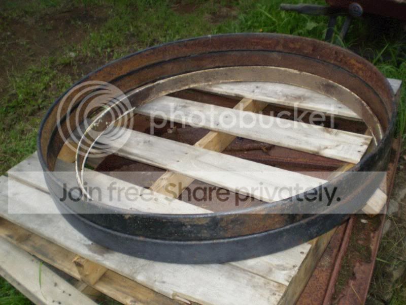

A friend gave me some big wagon wheel iron and of course i figured it to be steel or wrought as usual
but when i cut a chunk out and ground a bevel then etched it this is what i found . It seems to be two
types of metal welded together now this is new to me but i was wondering if anyone else has seen this before?
This stuff is 3" wide and a 1/2" thick.
Thanks Bob

Bob, That's one of those 100,000 mile wheels. :D Never seen a wagon wheel like that and I've seen a few. I had an old farming tine that was laminated steel. Hardened steel with a mild steel core.
Thanks guys! Ray it brings a whole new meaning to steel belted:p
That would hold lots of possibility's if this was Hardened steel with a mild steel core.
Bob
I did have a piece of a very small wagon wheel, maybe 1" X 1/4 that was medium carbon steel. Made a blade or two from it. Did you try sparking the two different materials in the 100,000 mile wheel? That's pretty strange unless its a recap. :D

Fascinating stuff Robert. I've got a couple of pretty beefy wheels. Guess I'll have to do some etching to see what it is. Have any ideas how you might use that stuff?
Phil the pipehawk pictured in the link above was forged from the same type of wrought but it was only about 1 3/8" wide and 1/4" thick. I'm not sure what i will do with this big stuff. Lots of possibilities.

Bob, I think I'd get that spectragraphed to see exactly what it is. Very interesting for sure!
I'm not sure where i could have that done around here but i am going to heat a chunk up and quench in water to see if it hardens at all.

Robert, have you scored and broken any of it to see if the center core is wrought?
Keep us posted on the results of your findings on this mystery.

Alden yes i did cut and bend and it seemed fiberous, very fine fibers but it being so thick and wide i cut probably most of the way through the center core before i could bend the piece with a 16" pipewrench. If you look at this link http://forums.dfoggknives.com/index.php?showtopic=17351&pid=161637&st=0&#entry161637 you can see that it is the same stuff as Patrick posted just maybe a little cleaner but after spark testing it is wrought iron for sure.

Since that stuff obviously welds up to each other, there are some pattern welded possibilities there for sure!
And they etch differently as well.
If you need anyone to help experiment, I'll send you my address!
Hmmm...One might think that there was a difference in carbon content in the different metals, forge weld-fold up a piece several times and see if there is a difusion of carbon content and what the hardening results are. Or just hack saw up a small piece and treat the inney and outey separately to see what happens.
