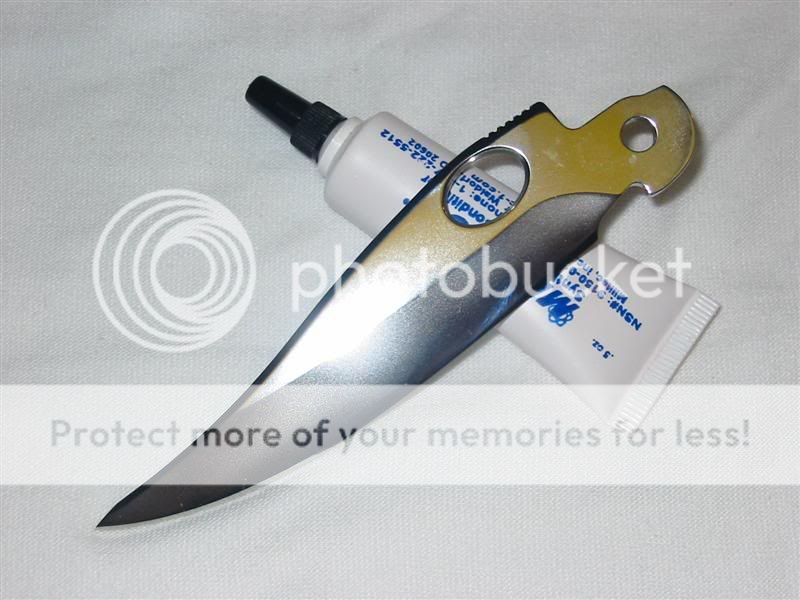

allyourblood said:
Steven: yikes! that's a winner!! i require details as to how you've arrived at this sexy specimen!! please! :eek: (the finish, of course. i won't touch the shape!)
abe m.
Simple. Get a buffer, apply some green buffing compound and buff away! :D
Well, it wasn't quite that simple, but close. Most of the BT2 came off with the buffer. Some parts, like the opening hole and around the pivot, required some hand sanding, particularly the flat inside the oval. From then on, it has all been hand polishing. Hours and hours of hand polishing that is, with Puma and Mother's specifically.
Believe it or not, the highest grit of sandpaper to touch that blade was 600 grit. There are some minor spots in the blade, but that is to be expected. They wouldn't have come out without days of hand-sanding.

Yea, the grind is pretty sweet. It is more noticable on the Mini AFCK, but I like the way the AXIS AFCK turned out too.

It is a Baldor buffer with some mystery green rouge.
