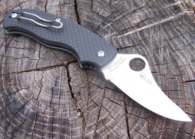

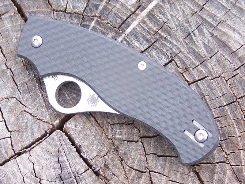

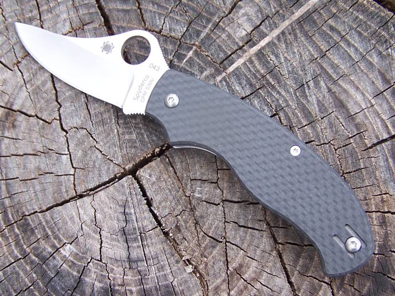

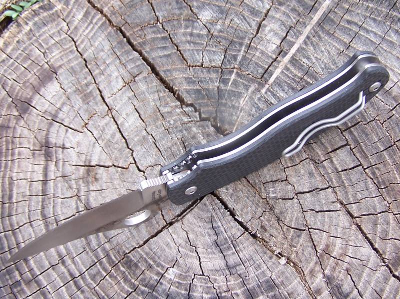

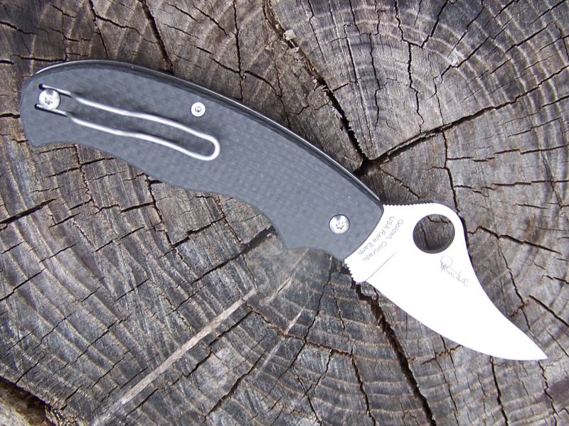

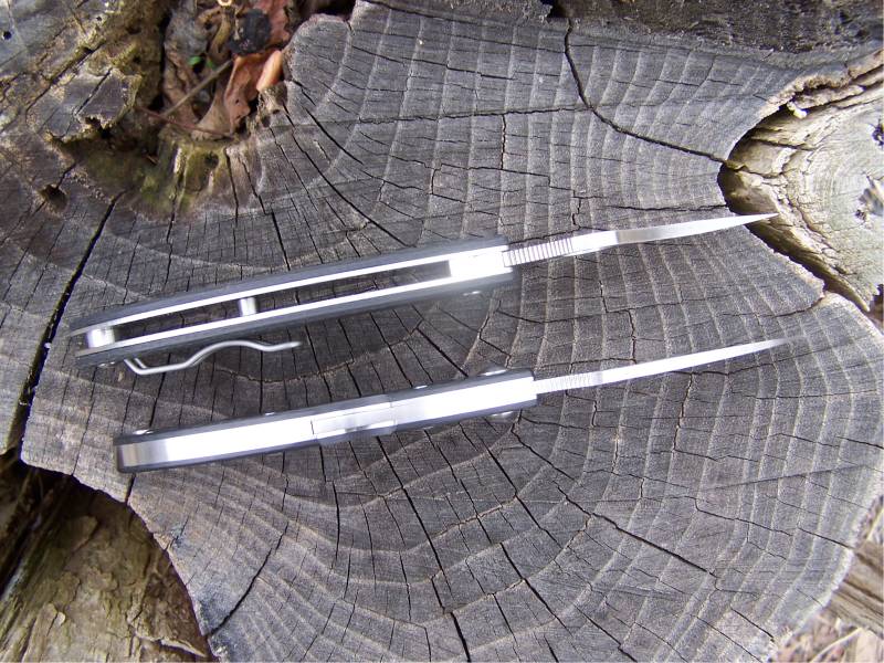

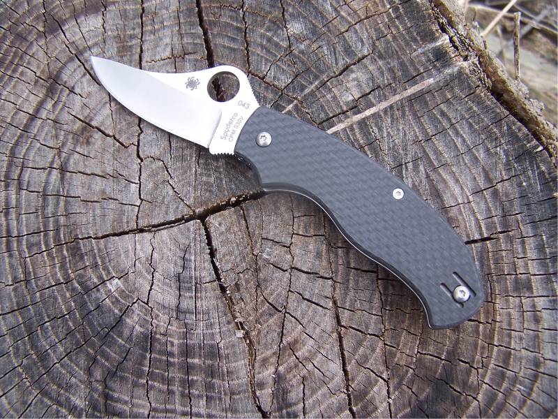

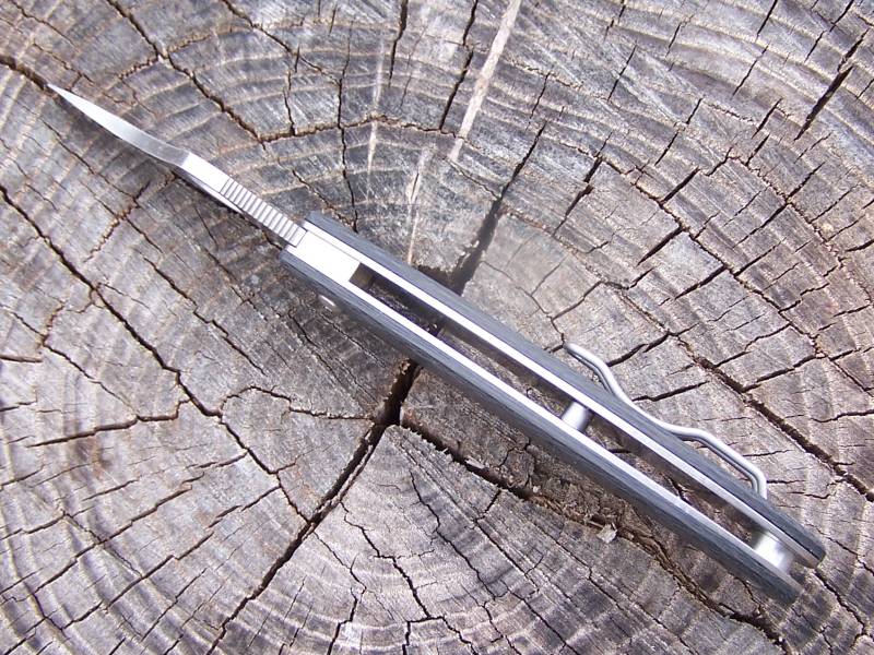

Here are some photos of mine...

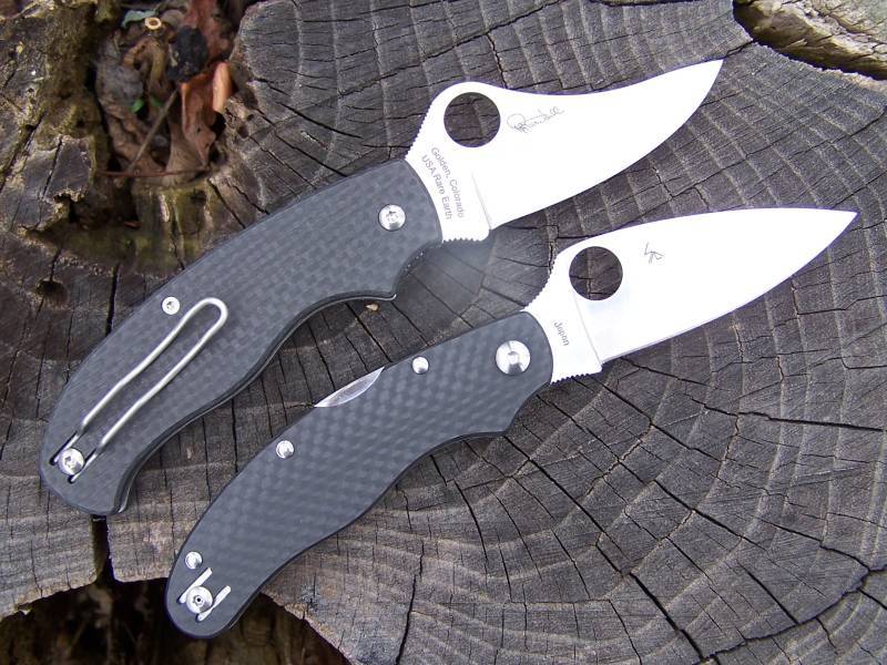

And a couple comparison shots of it and the Caly 3...
I'm keeping my T-Mag because I consider it to be an interesting collectible. I have a hunch it will probably be the only production knife ever made using this particular blade retention system. However, it is definitely not a knife I would ever choose to put in my pocket.
If I want a folder that size, I'll carry my CF Caly 3, or my grey FRN Calypso Jr., or the A.T. Barr One Eyed Jack I just received yesterday. Locking knives are still legal here in NY, and as long as they are, can't see the point in handicapping myself by carrying a non-locking folder.
If I was forced to visit a place where locking folders were against the law, then I'd carry my UKPK or DKPK since they inspire as much confidence as a slipjoint can. Releasing the blades on those two takes a considerable amount of deliberate pressure. The blade of the T-Mag, on the other hand, will un-stick itself from the magnet if you move your arm downward rapidly and stop suddenly. It can be both flicked open and flicked closed with relative ease. Since every country I know of that is hostile to locking knives is even more hostile to "flick knives" I'm also not sure I'd want to bet that every minion of the law would feel the lack of a lock exempted it from being labeled one. Even here in NY where the law very clearly requires a gravity knife to lock, I'd bet that not every cop on the beat would be aware of that.
The instructions do warn that one's finger should be kept in the choil. I realize that is, to some extent, the typical CYA BS that an overabundance of lawyers coupled with a dearth of people with any concept of personal responsibility has created here. They also warn to keep it away from magnetic media. Again, probably CYA to some extent, but in this day and age of credit cards, magna-stripe key cards, USB drives, and other similar devices, this does reduce one's carry options.
The magnet, by the way is the rectangular block of metal between the liners and just behind the blade in the 6th and last of the photos above. Action is butter smooth, probably beacause there is no resistance except for the side pressure of the liners against the blade tang.

Deacon, Is it just the picture or does your Caly III have a lock without the Boyle dent? Mine has one, I thought that all of them had the dent.

Your eyes are not playing tricks on you, and I have not been playing with Photoshop either. :D That particular Caly 3 was a very special gift from Sal. He had it made for me without the Boye dent. There is only one other like it, destined for the Spyderco museum. Been carrying and using it pretty much every day since it arrived two months ago.
