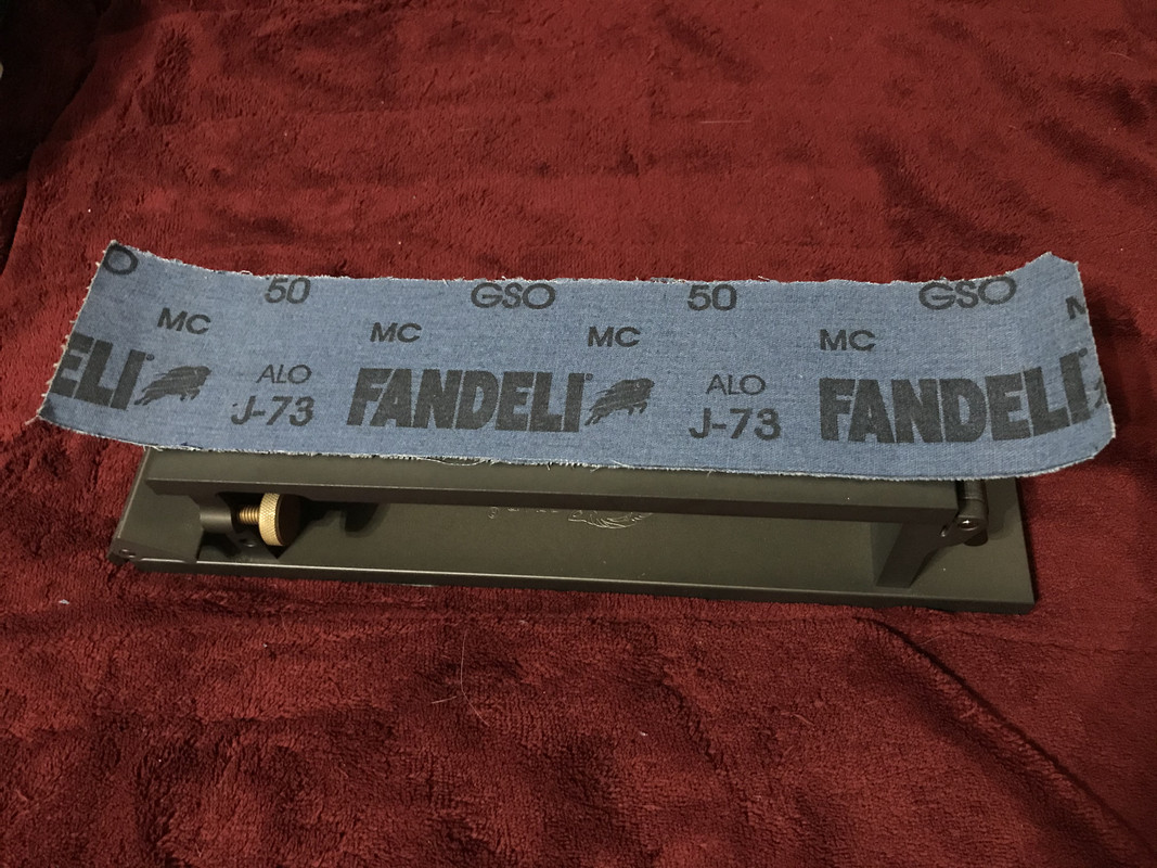

Got it in, been using it.
Well packed and came in a nice wooden box.

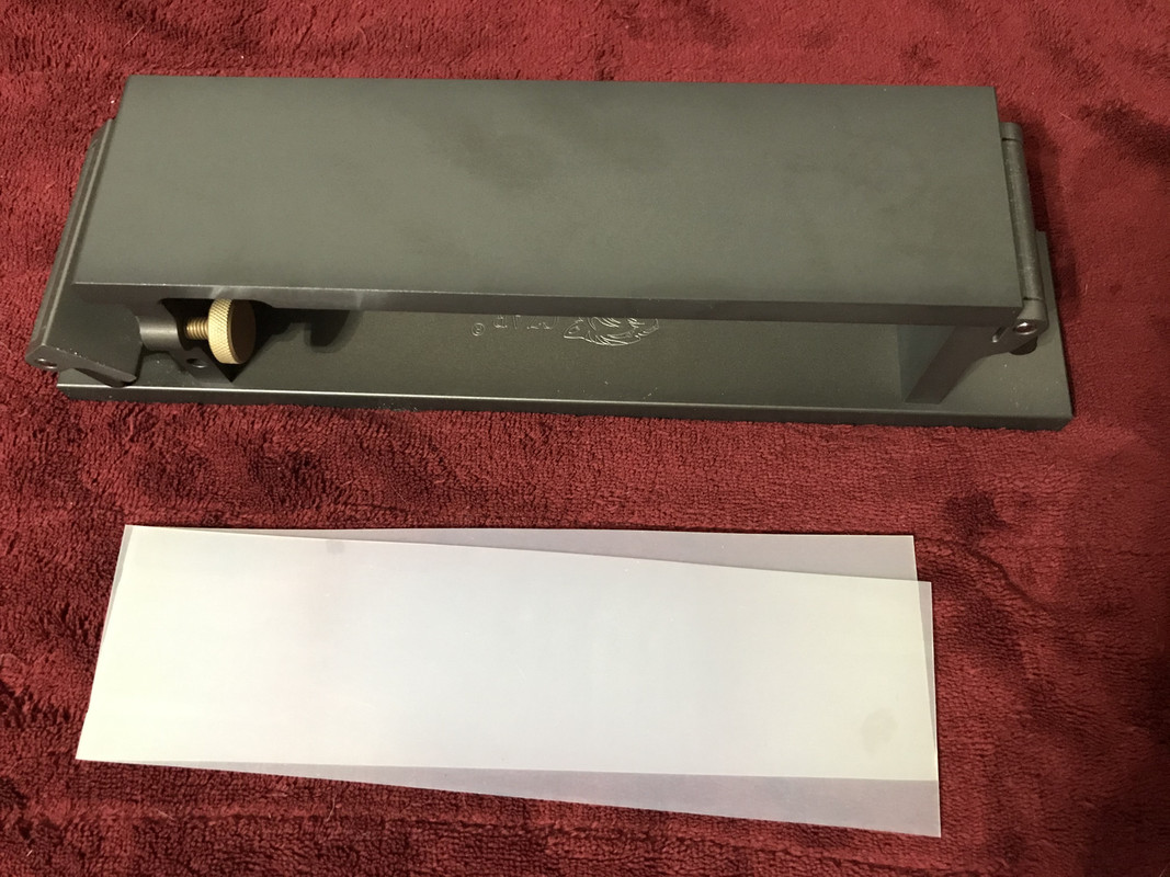

It included a couple silicone rubber mats cut platen size. One measures .060" thick, the other .040", combined for .1"

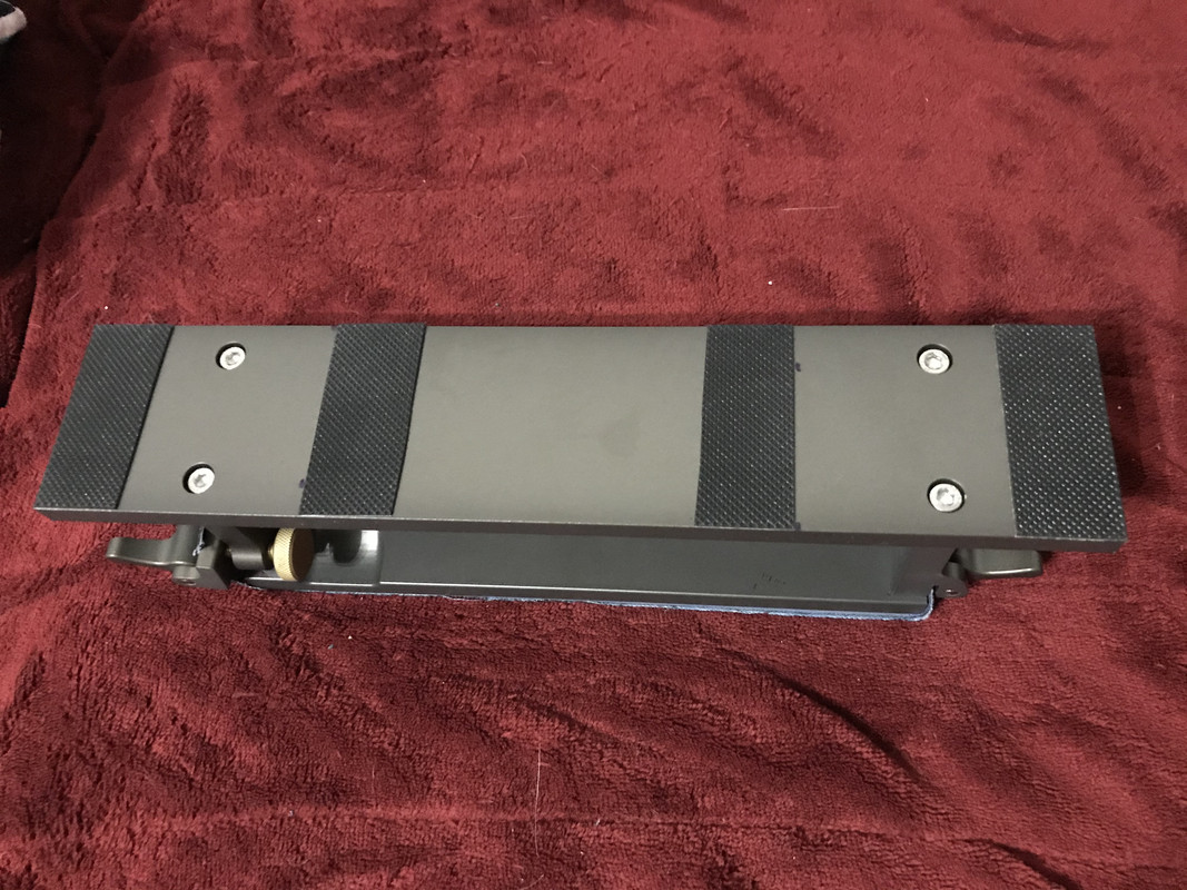

Also included was a textured sticky back square of rubber/plastic. As there are no instructions, I assumed this is meant as anti-skid for the base. Right or wrong, I cut mine in 4 pieces and attached them to the bottom to keep it in place on a slick surface, works well.
Measurements are
base 11-1/4" x 2-5/16"
platen 8-7/16" x 2-5/16"
height 2-3/4"
Weight 40 oz.

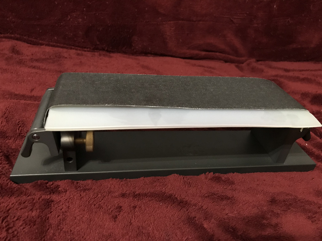

I cut my thickest paper to size, 50 grit (.045" thick), and it fit the slots with a little coaxing. With a little wear on the abrasive, it slides in and out easily. The thinner paper, .01" thick, of course fits easily. Both papers clamp securely with no chance of slipping.
The tension adjusters are solid brass screws. I don't have a gauge handy at the moment but the outside of the threads measure .235" and are coarse, smaller than 1/4-20, larger than #10, #12 maybe?. The head is knurled and beefy, .7" diameter and .25" thick, offers excellent grip and makes it fast and easy to tension or loosen the paper.
I'm happy to report that standard 11" length paper cut 2 and 3/8ths wide fits perfect, with a little length to spare.
With paper clamped and tensioned, it lays perfectly flat. So far I've had no trouble with the edges. Loosening the tension allows enough slack to slide the mats in and out from underneath the paper, without unclamping the paper, which is convenient.
While using, it's rock solid with no wiggles, rocking, sliding, etc.
All I've used so far are the 2 sand papers mentioned above. Eventually I'll cut strips of plain paper, cardboard, denim, etc for hard backed stropping. I'll also cut some thin foam like material, like a mouse pad for softer backing than the included mats.
