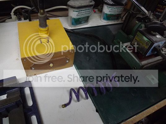

I made the mister for my mill, all I used was a rubbermade bucket, made a lid,
an old regulator to control flow, and a fish tank pump.... works great!
I don't know if pics are cool here, but here is a pic of the top. I'll get more soon.
Email if you have a question.

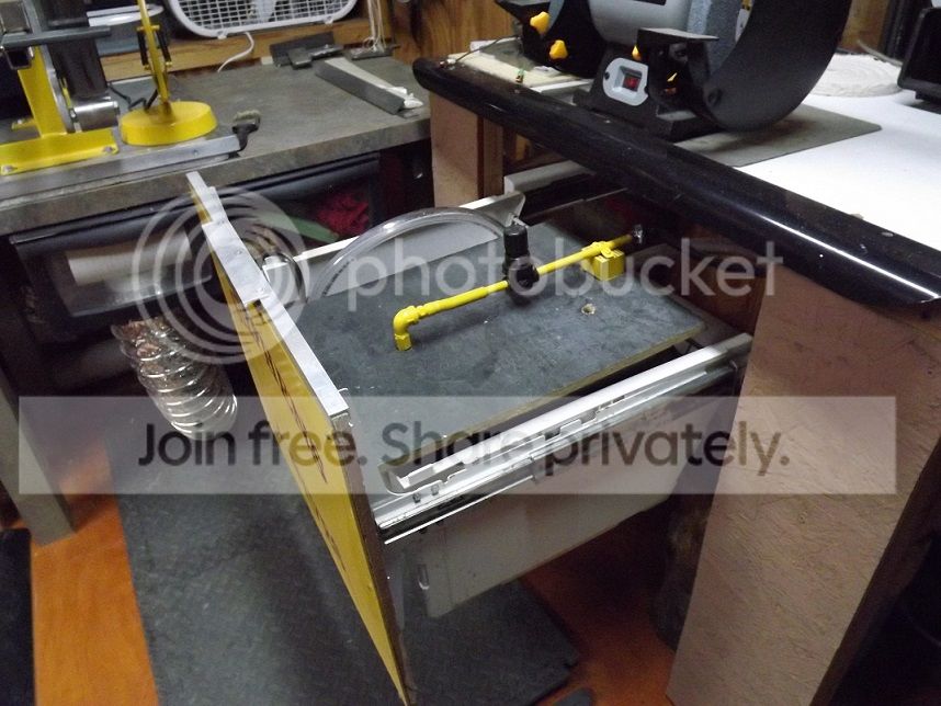

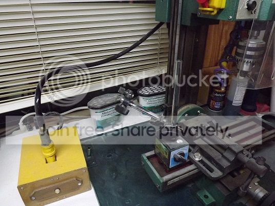

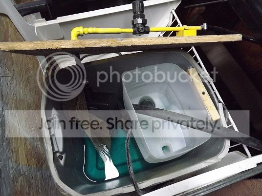

Here's a few more pics of the one I built... It's a pretty simple set up...
The fish pump pumps the coolant from the tank through the regulator to the
spray nozzle, and I use the regulator to regulate the flow of coolant.
The coolant returns to the tank through a return tube hooked to the bottom
of my mill catch pan... works very well, nice constant spray mist... or remove
mister head and turn it into a flood system...
Vern
