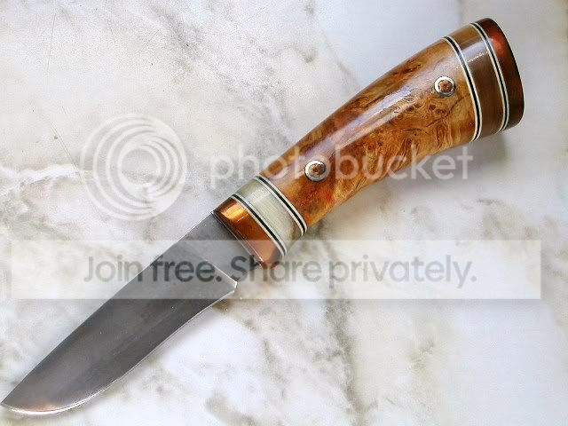

I use copper pins, liners, & guards It's a lil softer than brass but I thinks gives a knife a really diffrent look. I enjoy using it for the accents.
Jason
Copper is wonderful to work with. It files and finishes beautifully.
It burnishes better than most any other metal.
I especially like it for guards. When you seat it on the shoulders of the blade, it looks like it disappears into the guard.

Fred, Very nice nice knives! Plus you've convinced me to get off the fence and buy a bar of copper to make some guards.

I use it for guards a lot on hidden tang knives. Like has already been mentioned, it heats up extremely fast, so you have to be careful grinding it to shape. I rough grind it to shape before I attach it to the blade, then it's files and then sandpaper from that point, just because the heat build up can mess up the epoxy in the handle cavity. (I hope that makes sense.)
