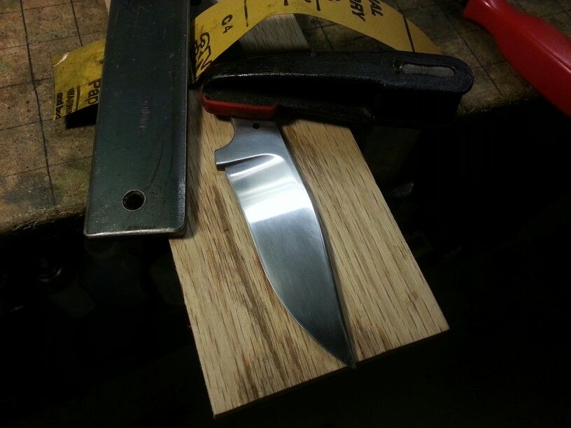

anything i should change before heat treat.
Dec 21, 2013
336
[/url][/IMG]
anything anyone thinks I should change before I heat treat it tomorrow?
this one will get a highly configured curley maple handle. not sure if I should leave the file marks, do a mirror polish, or attempt to get a nice satin finish.
How thick is your steel? Your bevels look way to short. In other words your flats are too steep. Makes for a rough cutter... trying to push too much steel through behind the edge.
Peronally I would go for a high flat grind...
This is 5/32" and about .020 at the leading edge prior to putting the cutting edge on it. The higher grind means a narrower angle passing through the material the edge cuts. Slices better and is plenty tough with a good HT.
Are you sending it out?
It looks like you still have a lot of sanding to do before HT. I would take it to 400 grit and have all scratches out before HT.
Are the pin holes their final size? They should be about 50% larger than the pins you will use.... e.g. for 1/8" pins, drill 3/16" holes in the tang.
I also agree that the bevel should be much higher. I prefer full flat grinds, where the bevel goes all the way ( or nearly all the way) to the spine.
For future knives:
This one looks "stiff". It is a straight bar of steel with a knife shape filed into it. Making it from a slightly wider bar and putting in some curve will make a much nicer knife. A good knife has what is called "flow". That is when the features work together and smoothly flow into each other. Such a knife not only looks better, but works better.
Look at the photo LucyCustomKnives posted and see how much difference there is between his and yours. Looking at some of the knives in magazines and The Gallery will give you many ideas on adding "flow" to your knives.
I also note that the holes in the tang aren't evenly spaced or in a straight line. If you ever plan to address that you need to do it before HT. And do you really plan to put that many pins in it?
Yes, there are changes that need to be made.
The grind needs to come up higher like LucyCustomKnives and Bladsmth both stated, at least another 1/8", but 1/4" would look better, it would then be closer to a full flat grind (FFG) like Stacy prefers.
The handle needs more holes drilled in it for weight distribution, a blade heavy knife is usually more comfortable to hold and use (just my opinion there). The epoxy will also have more surface area to grip and will create hidden epoxy pins by filling the holes.
Like Tryppyr pointed out, you don't need that many pins, two or three will look best and "flow" better. Just make sure they're evenly laid out.
You do need to remove the machine marks. A 400-600grit hand-rubbed satin finish would look very nice, all of the scratch lines need to be running the same direction without any fish-hook scratches. This needs to be done prior to HT so you won't have as much sanding to do post-HT. Sanding hardened steel is a major PITA.
ty everyone. im doing ht myself. it is approximately 1/8 thick.
ty everyone going back to the shop to do some more work on it. bringing the bevel up much higher, drilling bigger and more holes. im only using three of the holes others are just going to be for weight reduction.

[/url][/IMG]
progress update
should I take it up even higher before ht or wait it is 5/32 not 1/8th.
Higher is better. Also, when hand sanding the bevels you should use a sanding stick or specialized tool to keep the paper flat and the lines sharp.
ty tryppyr I just used fingers lol
thought I might be able to get away with that until after ht anyways .
The tang holes should have a bit of clearance all the way around the pin. If the pin was a snug fit and you peened the pin, it may spread at the tang as well as the end and raise the scale up off the tang. Also, aligning pins through three holes through two scales an a tang is dang near impossible unless there is some slop in the tang holes.
Drill tang holes 50% larger than the pin/rivet. For an 1/8" - .125" pin that is 3/16"- .185". That will allow a clearance of only three one-hundredths of an inch around the pin. take a calipe and open it to 3/100" and see how thin that actually is. For 1/4" pins, the clearance is only 6/100".
For mine, I drill the holes the exact size of my pins. Drill a hole, pin that one, then the next, etc. I do each side with temporary pins (that is lightly sand and then polish so they slide out a little easier) and shape my handles to final shape. Then I drive out the temp pins, finish the blade and tang. I don't peen radically with the final pins, just a light tap before smoothing them to size. That is done as part of my final glue up and finishing.
There is nothing wrong with the bigger holes, the epoxy will take care of the space. I just like my handles to basically be affixed to the point epoxy would probably not be necessary. There is nothing wrong with finishing your handles with the knife. For some projects I finish then this way. I etch a lot my blades though, and have had the FeCl color light spacers faintly in the past. So now I finish the blade with scales separate. It also allows me to cerakote or blue the knife without the chemicals getting on the scales. It also allows me to pin just the scales together to ensure they are exact copies of each other... Works well for bookmatching spalted scales and such also. Always finish the leading edge of the scale to final finish before its on the knife, then you don't have an issue of working against the blade.
I also try for either a blade heavy or dead neutral balance. I also like as few pins as possible and may only expose one or two, and use stubby thread rod for the others. For that I undercut the drilled holes in the scales slightly to create a ledge of sorts for the epoxy. With this method, I have driven a stake with the handle of my knife before and had no issues... With modern epoxies, only a couple of pins are necessary. They basically retard lateral movement saving the epoxy bond... For a small project I have gone with no pins at all... just texture and a couple if small holes to hold the scales. It was a personal project and I'm waiting to see how it holds up. I use G Flex BTW.
I also go to at least 600-800 grit prior to HT. That plus atmosphere control equal very little scale. Reducing scale saves time and belts...
Cheers... good luck.
