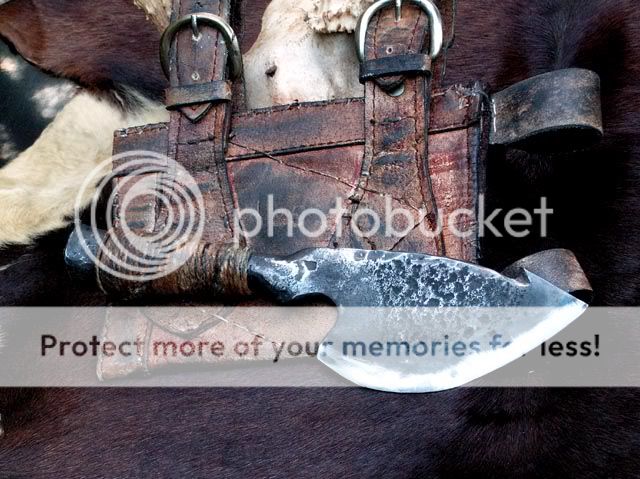

This started as simply an idea, what could we make out of readily salvageable materials, homemade forge and tools, to protect and feed my family in the event the power grid dies.
The first 3 met those requirements. All big and capable choppers. Made from materials readily available. But they lacked something ..Diversability ..So after thinking long and hard I introduce
Armageddon

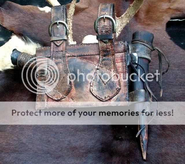

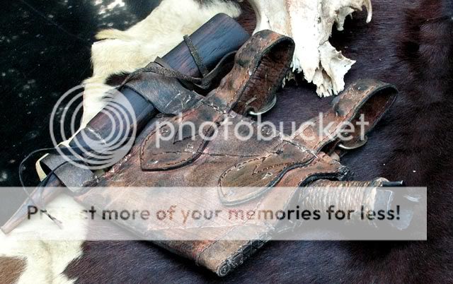

Total package 10″ x12″. Made from a pieces of a leather hang up travel bag from the Salvation Army store.
I see a socket handle, a kiridashi and a burnt stick. Buckles allow hanging from a belt or pack.

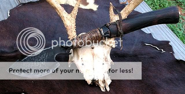

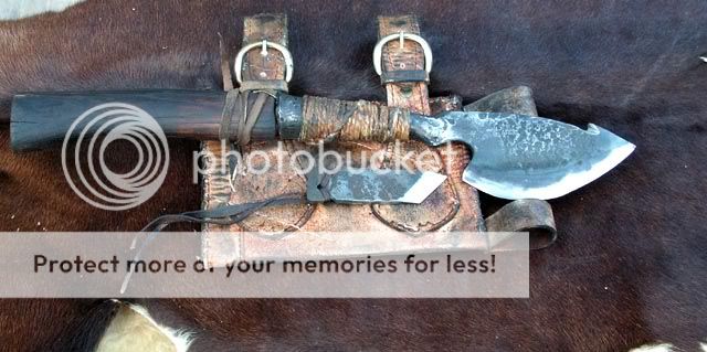

Socket handled Ulu- Skinner w/ gut hook made from a mid 1940′s mower blade. The finger hole/choil was the blade mounting hole.
Forged, hot cut and a bunch of hot filing. Edge quenched in salt water. Shellac saturated hemp twine wrapping on handle.
Heres that burnt stick. Actually a broken hatchet handle. Whittled to fit the socket handle. No dye, oiled, torched and scrapped.
The leather thong ties it pretty securely to the Ulu/Skinner to make an impromptu hatchet.
I dont know where this series is going from here But..I do have the workings of a flintlock pistol??.........Randy
