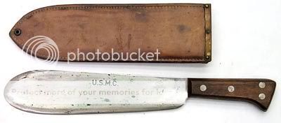

Thanks Gentlemen. And the sheath is very simple, I remember Dad's Bolo as having a simple leather sheath with a wire hanger that fit in the holes of his Military issue belt. The same belt that was very familiar with MY south end............Randy
I don't know what happened to his but here is a pic of one.
By the time we ( 3 boys) grew up it had been sharpened into a big recurve ......Randy
