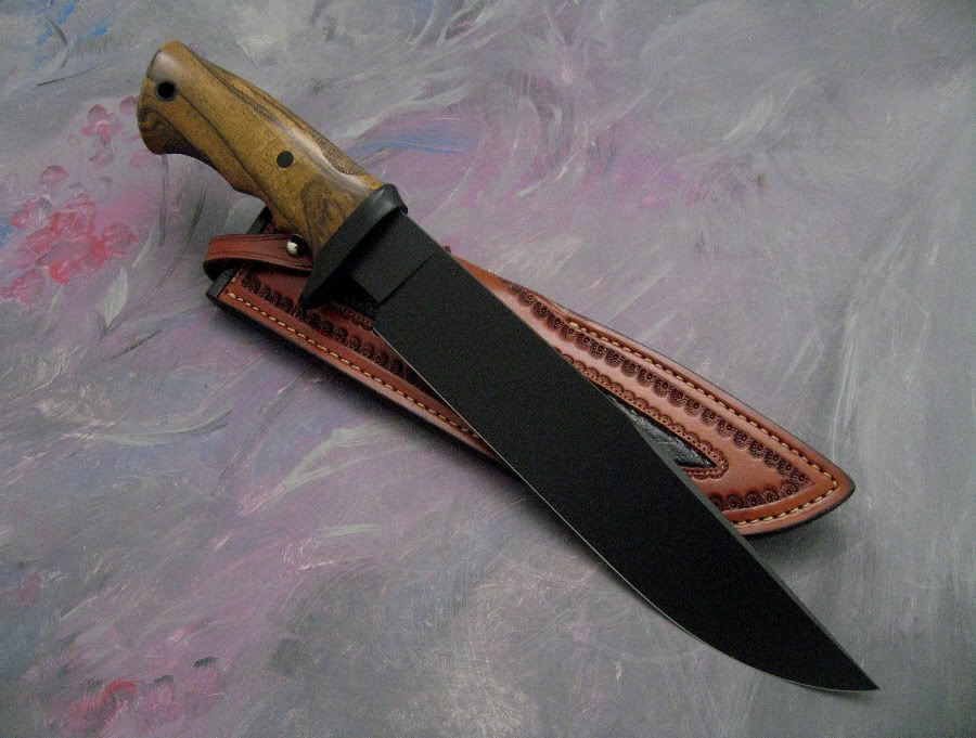

Dan Farr has an RJ Martin black powder coated folder that he uses as his shop knife and has done for years. You can tell it has been used (just as you could, I suggest, on any knife that has seen that much use) - but the coating most assuredly has NOT rubbed off.
Now, will it wear off "in time"? Well, time is technically endless, so that doesn't provide a meaningful point of debate. But the durability that the coating on that knife has displayed through years of hard use satisfies me that wearing off is simple a non-isssue. I can't speak for all powder coated knives, of course, but Dan learned how from RJ, so my confidence level is pretty high where his stuff is concerned.
This type of finish holds a lot of appeal for me on a using knife where you want to be ablde to use it hard, but don't want to HAVE to give it the degree of care and attention that a carbon steel using blade generally demands.
The downside - if you consider this such on a using knife - is that it can't be touched up or refinished to look like "new". Whether that purely aesthetic tradeoff in favor of superior corrosion and staining resistance is a valid one is a matter of choice for the individual purchaser.
Now as for it "looking bad" - no comment - your subjective opinion in this regard is just that.

Sorry for the not quite Coop image:D, pic was from the seller.
Uwe Hoffman Ranger, picked this up shortly after joining here.
Blade finish is Kal-Gard. Uwe was in a '98 Tactical Knives mag the seller sent me along with the knife.
Doug
