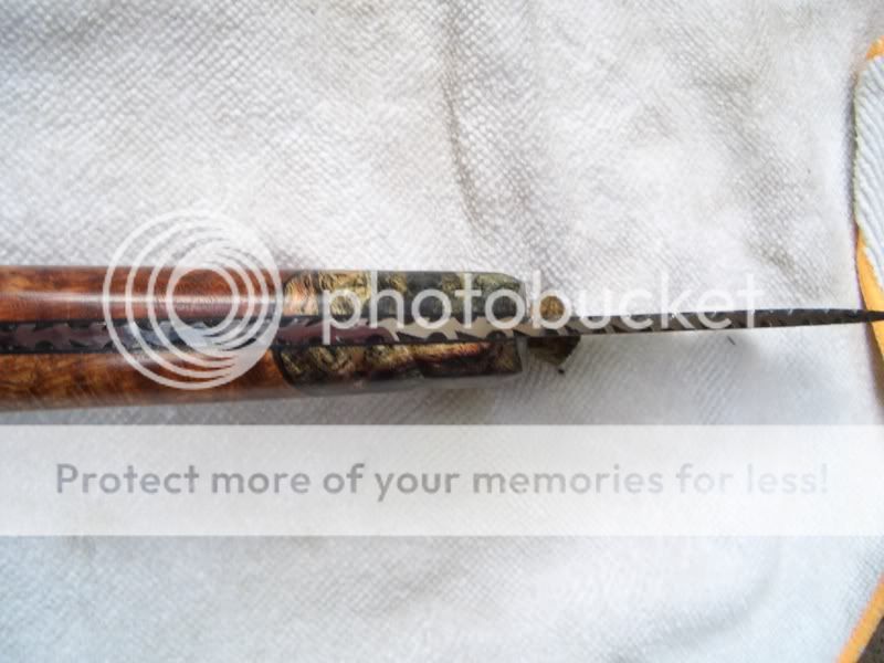

I have personally welded quite a few carbon steel tangs to damascus blades and they turn out quite nicec like this. Simply add filework (or not) to the spine and polish the spine and underside of the tang to a mirror finish after attatching handle slabs. Here's a pic. email with questions I would be happy to help.
Matt
I've seen the blades you are talking about. They weld the Damascus onto standard steel to keep the prices down. The tang is NOT damascus.
