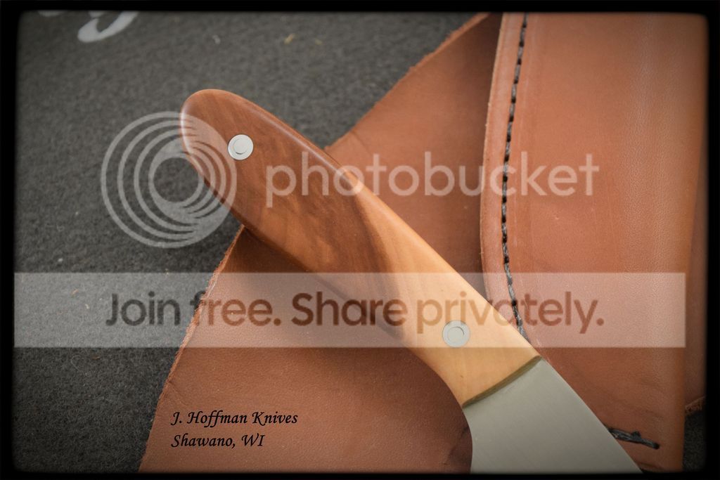

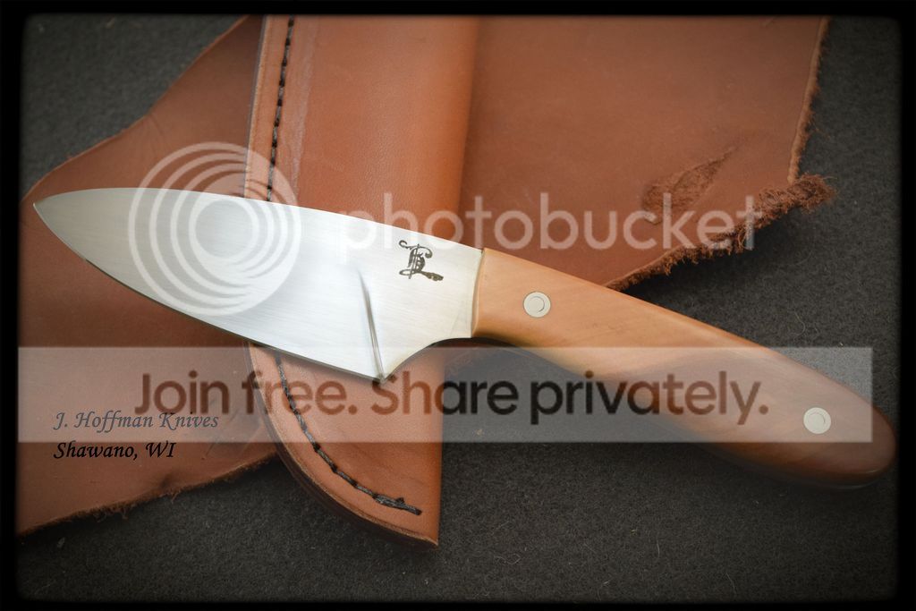

I made this one earlier this year with a piece of two-tone apple. It has a really neat creamy color. It's got plain grain, but I love the color.
