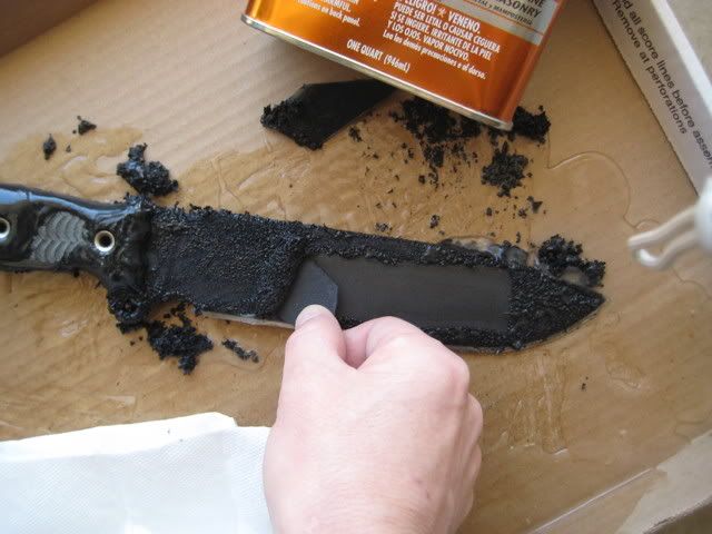

Never met a coating that could go one round in a ring with this stuff. It just bubbles it up and wipes it out. Just a gentle scrape with a scrap of kydex cleared the coat off this one.
^^^^^^^^^ nope, it has zero effect on micarta or g10.... but wear latex gloves (learned that AFTER the above pic). It will burn your hands after a minute or two of exposure. Nothing major, soap and water washes it off fine. Fumes can be harsh. Wouldn't wanna huff it for a living.
I've probably used it a dozen or more times on coated knives with no issues whatsoever except I seem to crave beer more nowadays.... hmmm. :confused:

Able, The finish is tough, in my opinion is the hardest to strip of any busse coating since the shbm smooth coat. With that being said I think it would make an excellent chopper and for sure will hold up like no knife ever. Buy it beat it and then show us

I stripped an arctic white snakeskin sfno back in 2010, no black under, just white and had to let the kleen-strip soak a while to get it all off. That one and my urban camo hg55 were two of the toughest to strip.
I hear ya on the urban camo... That Moabolo took about three runs of Jasco, . Actually it was a run of Jasco, then citristrip then Jasco again. Tough stuff when it's in layers

I've stripped quite a few pieces of Infi and SR-101, never had any issues. Tanker Grey is some tough stuff, but Artic White was a beast. 3 rounds of 3 different strippers sitting for max+ recommend time. Then many quick "washes" with more stripper. The white was thin, sticky and aggravating. I would do it again, don't get me wrong! Another odd thing after I stripped, white kept coming from under the handle! It just creeped out! The white never bubbled up, just got softer and very sticky and stringy. Have fun! ;)
