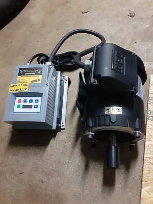

110V 3 phase motors don't really exist (yes, there are a few out there, but the vast, vast majority of 3 phase motors are 230V/460V). I'd recommend getting a VFD that outputs 230V 3 phase power like the KBAC-24D. A TEFC (totally enclosed fan cooled) motor is what you really want for longevity. While it may not see as much dust as a belt grinder, it will still accumulate some over time and a properly sealed motor will survive in those conditions indefinitely.
Edit: You'll want a frame 56 or 56C motor; they are the only NEMA motor frame sizes that have 5/8" shafts.

That motor on the NorthRidge must be a 3-phase, the KBAC converts your 110V to a higher voltage. You want a 3-phase motor to connect to a VFD. Your motor should have a plate on it with all the specs.
Just to clarify, the KBAC-24D and 27D are dual voltage VFDs, quite uncommon actually. They'll take either 115V (110V, 115V, 120V are all synonymous in this context) or 230V single phase input and output only 230V three phase power. VFDs can only power three phase motors and your single phase wall power can only power single phase motors.

1.) Get a hybrid KBAC VFD (24/27) (single phase 110 in and 3 phase 220 out)
2.) Find a totally enclosed, ~1800 RPM, 5/8’’ shaft, 220v 3 phase motor ~1.5HP so it can be downgraded to around 1HP
The 24D is for up to 1hp motors and the 27D is for up to 2hp. So, if you wanted a 1.5 motor you'd need the 27D.
For my 9" disc grinder, I used the KBAC 24D and a 1hp motor. I think that's enough for a disk that size. I use it with light pressure.

Not sure why you want to downgrade a 1.5 HP to 1 HP? With a KBAC-27D, you can run a 1.5 HP on 110 V, or downgrade a 2 HP to 1.5 HP.
If you are getting a new VFD for a disk grinder to run on a 110 V outlet, my choice would be the KBAC-24D and a <=1HP TEFC 3-phase motor. The IronHorse 3/4 HP 1800 rpm is probably one of the cheapest options at $175. As far as I know, there are no other VFDs that run on 110 V. If you have 220 V, there are more choices, but if you want a NEMA-4 (dust-proof) enclosure, there are no great cost savings compared to the KB drives.
I just mean that running a 220v motor on 110v input would likely provide less power than the spec plate says it will? So a 1.5 HP 220v motor would really provide around 1HP? Just guessing here.
Nope, the VFD is up converting the 110v single phase to 220v three phase. Your motor will run at name plate specs. The 24D on 110v or 220v will power a 1 hp motor perfectly. The 27D on 110v will power a 1.5 hp motor perfectly and the 27D on 220v will power a 2 hp motor perfectly.
