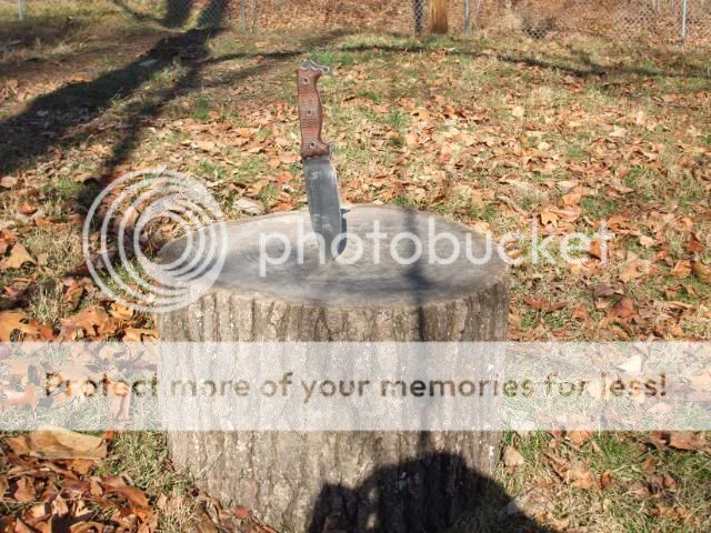

okay here yah go

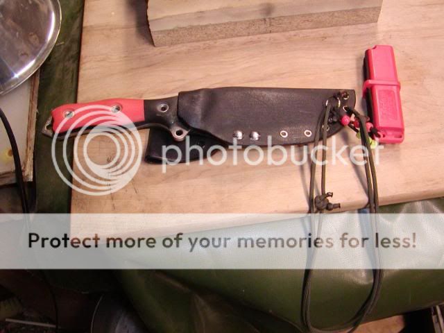

just cg butt what's a thread with out a little boose???????????

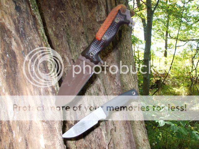

DMLE
