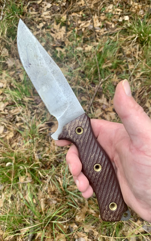

The Crucarta PM2 has scales that aren't like any other micarta I have. The texture is like cloth. Any of the others have a feel that's more like G10.
Love that copper handle! I have one with a black blade. My favorite PM2!
