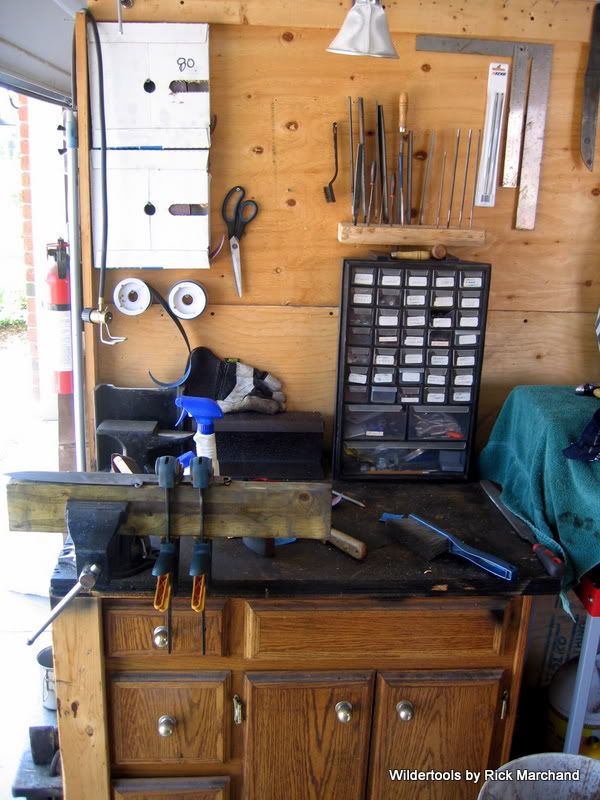

My sanding bench, complete with shop rolls...

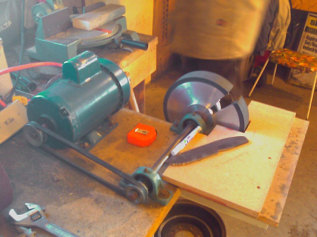

The_cutting_edge, what kind of grinder do you have that takes shop rolls?

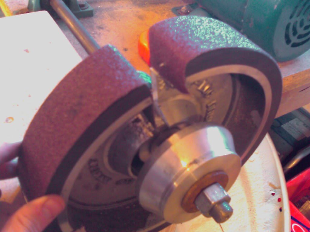

My grinder is a 2" x 10" cone-loc drum sander. it takes shop roll belts
here's some pix

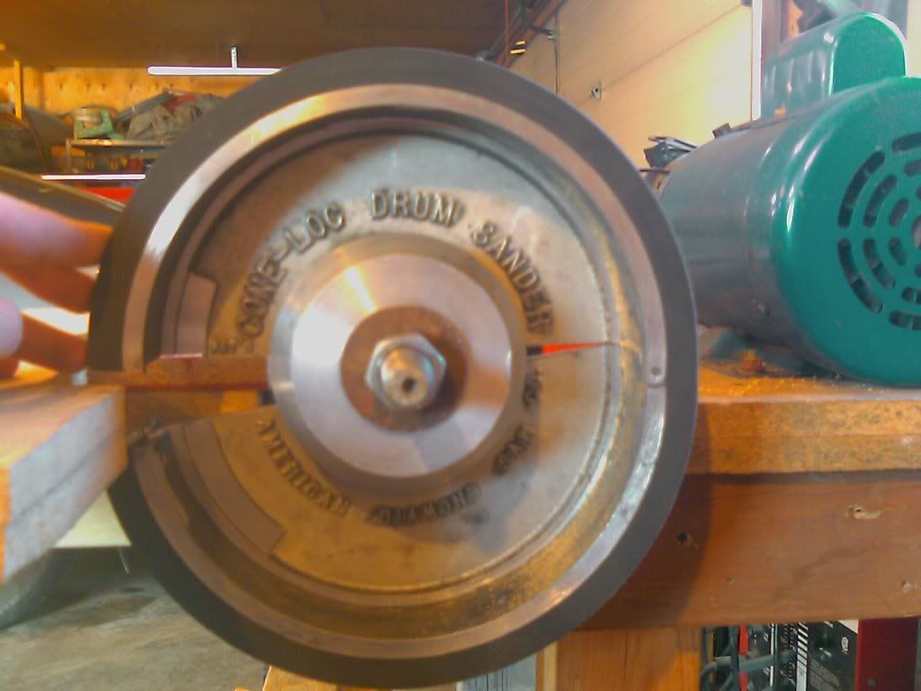

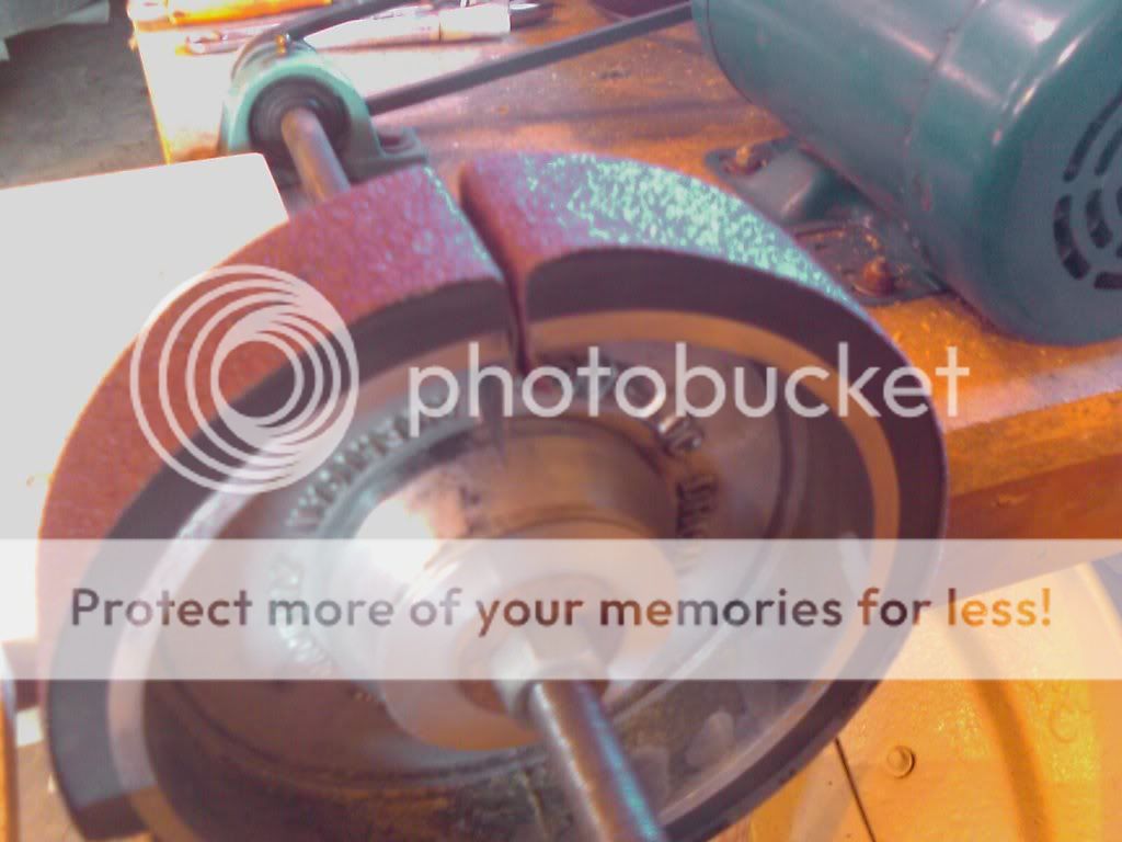

it opens pac man style and there are small spikes to hold the shop roll.
as you can see in this picture once the wheel is closed there is a cone shaped protrusion in the centre and a hub with a matching inverted cone. when the hub is tightened it squeezes the wheel closed and keeps the belt tight.

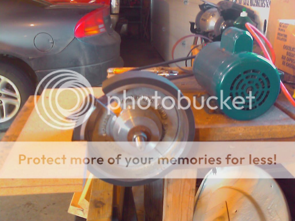

heres an action shot.
since these pics were taken I have ditched the makeshift work rest. it got in the way for changing belts.

The_cutting_edge, thanks for that, I had remembered seeing a picture years ago, but not how it worked. Any trouble with the stuff getting caught in the gap as it spins by? (I'm guessing not).
no. the thing spins at twice the speed of light so you dont even feel the small bump as it goes by about 150,000 times a second lol
