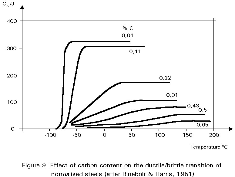

Of course steel type plays large role in subzero temperature behaviour.
Steel composition, used elements and their quantity is crucial for temperature where such steel moves from ductile fracture to brittle fracture.
Here is for normalized steel and Carbon content

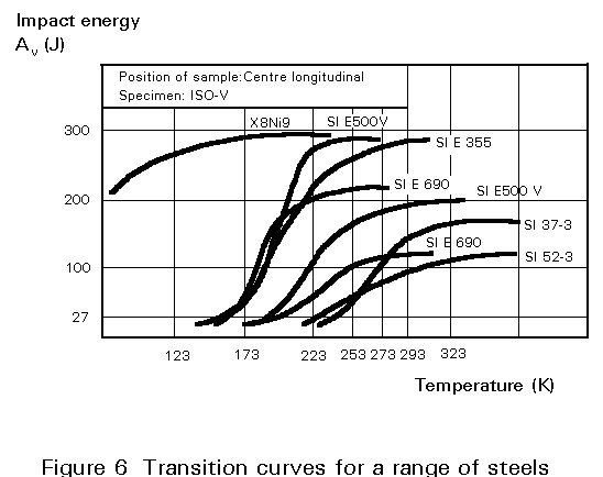

or some wider range of steels
How it applies to knives and knife steels?
It is quite simple.
You do not want stainless (i mean 13%+ Cr)
You want AS LITTLE carbon as possible (lets say 0,4-0,5%)
You want nickel - that is crucial element for cold temperature.
And you want secondary hardening steel - coz martensite is then much more temperer - and more ductile therefore.

I been looking at steel composition charts for about an hour. That looks like a specialty steel that is hard to match with most knife steels.
