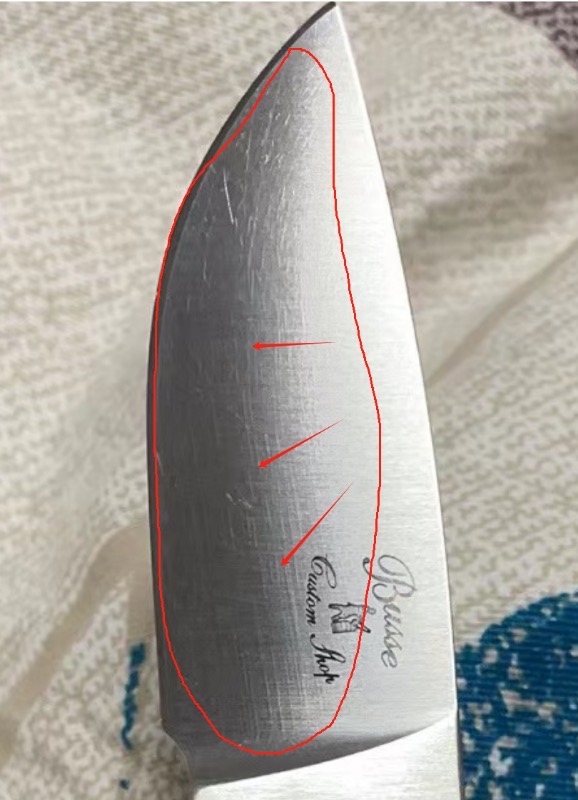

What are these strips?
There is also a video, I believe is by another member here.
And there is a comment analyzing the strips, just as a side note.

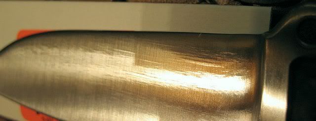

Don't panic. . . It's a good thing. . . 👍
What you're seeing is the grain stucture of the steel. . . .They all have it. You have to hold it at the right angle to see but they are there... 👍
They are created when the steel is rolled lengthwise at the mill. . .. and just like wood, the direction of the grain adds to the lateral strength. . . .
Think of them as nuclear rebar reinforcing the blade. . . 👍

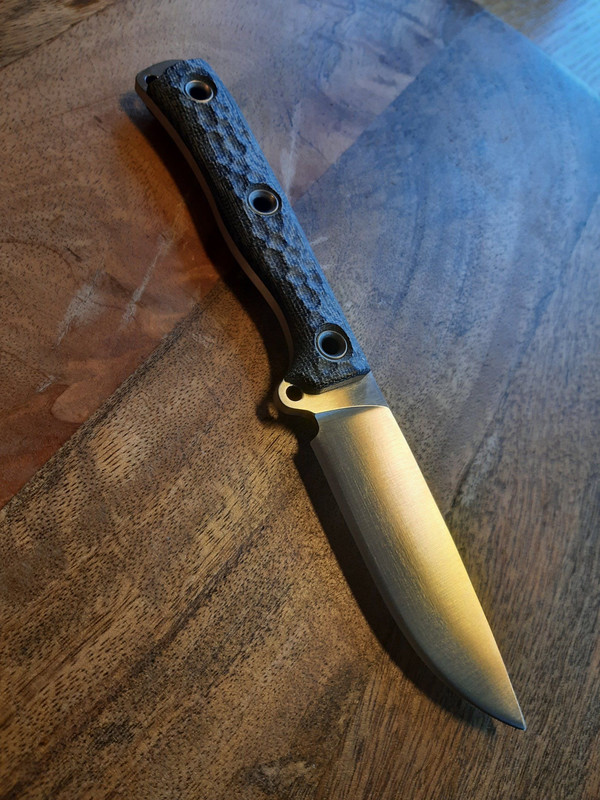

Can someone point me to a photograph that shows actual carbide banding?
I just recently traded for a knife that has weird little horizontal artifacts in it.
I think these stripes are in deed carbide banding.
Ideally we don’t want them, but it is not necessarily going to be a problem.
Carbide banding are caused by the slow cooling rate of large ingots, powder steels cool very fast in atomizers, so they don’t have carbide banding.
However, when carbide volume is very high, even powder steels form clusters of carbide.

In my opinion, I think the banding happened in heat treatment.
Though banding formed in ingots can be removed by dissolving the carbides, the alloy elements stil can’t move freely as in molten metal.
Therefore, the alloy segregation is not fundamentally eliminated and carbide banding can reappear in heat treament.
And this is why banding appears to follow the blade shape, instead of being straight lines:
During low tmeperature cycles, as the blades cool faster around its edges and at thinner sections, banding formed according to the blade shape, along lines at the same colling rate.(think of topo maps)
I think banding is a by product of the protocol in combination with the nature of the steel, although banding by itself is not desirable, the overall protocol still yeilds great performance.

The blade I have the artifacts/banding on is in 14c28n... but the lines do indeed follow the curve of the belly all the way to the tip. The only other time I've seen weird artifacts in the finish of a steel was a Ganzo, but they weren't linear bands that follow the curve of the belly like this one.
Edit to add: the knife I'm questioning is not a busse.

I think the banding that follows the blade shape is the secondary banding that reappeared during heattreat.
