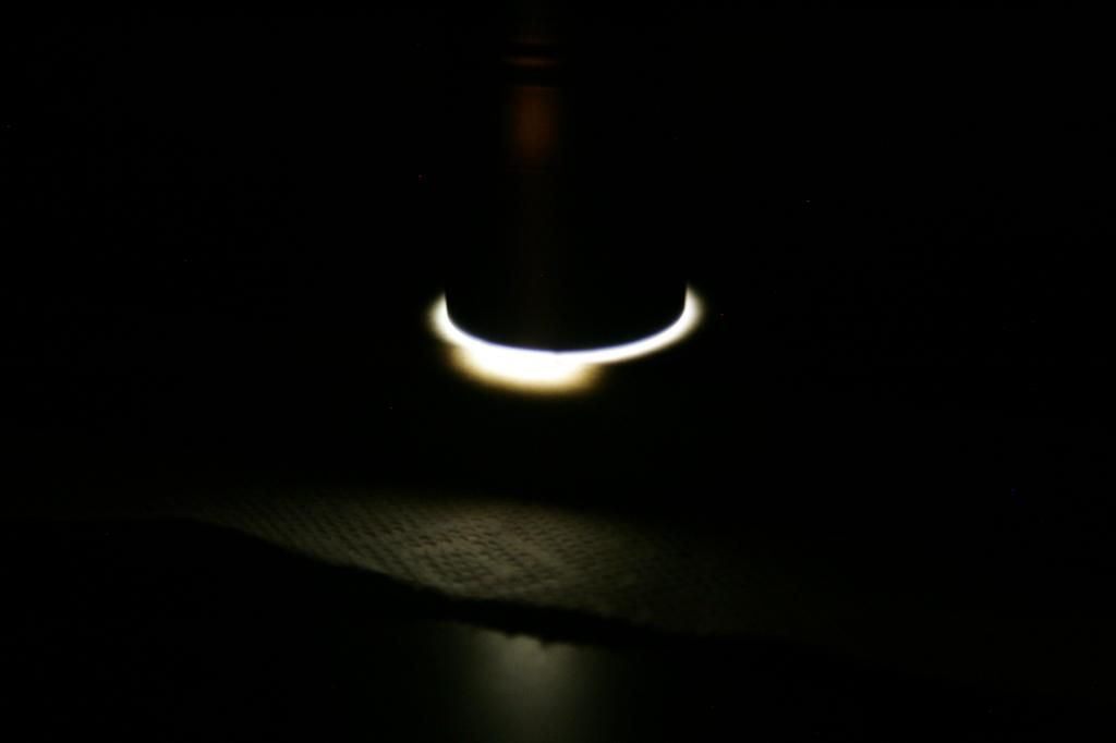

Yours isn't translucent. I have about 6 or 8 Arks, including several plain black. That one in the photo transmits just enough light to be called translucent. You can't see light all the way fhrough the stone but if you turn on a flashlight and place it on the surface near the side so that the stone still blocks the entire lens, you can see light penetrating about 1/4" into the stone. It also has small black dots and lines as you can see in this photo:
Here is a photo I just dug up of the translucence. The rim of the flashlight is inside the edge of the stone, and on a surface that isn't translucent, no light escapes.
