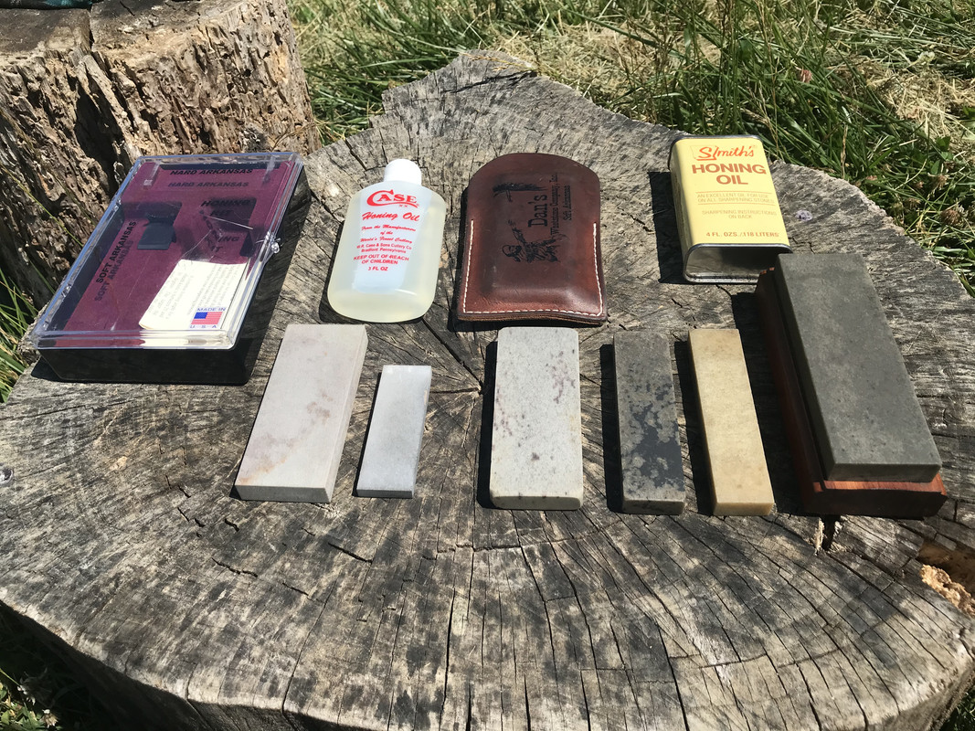

I got a proper picture of all my Arkansas stones together.
The smiths kit I bought after my house burnt 7 years ago. It was either unused or very lightly used. The plastic case was all busted up.
The case kit is modern. As is the dans.
And the unknown stone, it came from eBay some years back. Now, that stones color is the same as the smiths bench stone I had before the fire. When I purchased the new to me smiths kit, I was surprised that the soft stone was different. This dark grey and black stone produces an edge that is finer and more polished than the soft stones I have, and I think a little finer than the hard case stone, but not as fine as the translucent I have.
Case soft, hard. Dans soft. Unknown. Smiths hard translucent, soft bench stone.
I didn’t realize the smiths “hard” is actually a translucent. I think that the previous smiths stone I had was a translucent too.

I have had a couple of those type of Smith's. Lacking a better term I call them semi translucent. My experience with them is they are in the same class as the black and other translucent stones if given the same kind of surface prep.
I dropped one of them so am down to just this one. I think I bought it new in the 70's. It's a combo married to a soft that is pretty much worthless. For reason's I don't fully understand mine have been very fast arks for their hardness. In fact this example is faster than the soft it is married to. It never seems to glaze over so much that it stops cutting.
They were white at one time. This one has had a soak in simple green and is less yellow now. It would probably return to white given a long enough soak that would probably take months.
Dan's and Smith's were the manufactures of Buck and Case stones. I think Dan's had Case and Smith's had Buck but I might have that backwards.

That grey and black stone, anyone got any idea on it? What makes it different? We’re they uncommon or special?
It makes the best edge of them all, on both stainless and carbon. I dropped it too and busted a corner. Dagnabit.
I forgot to mention, I think it’s heavier than a similar sized soft stone. But I don’t have another to weigh.
I'm not a big fan of soft arks, even when I get a really good one which to me is a softer faster stone. I don't dislike them there are just better options with natural stones in the same range that the softs work.
It's pretty easy to check their density (specific gravity) using the water displacement method.
Take the dry weight of the stone first, then zero a container of water on a scale, suspend the stone in the water using a thin string and record the weight. Obviously with out the stone touching any part of the container.
Dry weight divided by displaced water equal the SPG.
