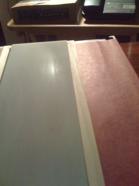

Here is a chunk out of one of my posts in another thread (was easiest to copy the photos so I took some text with it. I am talking about A2 but it applies to the steels you mentioned. I could dig up an augment to the contrary but the exception is when one is willing to cut grooves in the hard Ark stone . . . at a minimum that would entail scratching it up with a very coarse diamond plate or tile saw. waste of time / stick to diamond plates for the really super steels but the ones you listed can be sharpened on high quality man made stones designed to be used on your steel alloys:
natural stones and no problems with supersteels.
In emgineering they said any abrasive works, you might just need a bit more of some.
Moving on here is a photo of what an A-2 blade does to a very high quality translucent Arkansas stone. The blade had been sharpened to hair whittling on a series of Shapton Pro stones but had some slight, super thin, foily, wire edge and I was just attempting to take that off on the hard Ark. I tend to jig sharpen these blades with exclusively an edge trailing method unless I am hogging off a lot of metal on diamond plates then I go both directions. On the hard Ark I was using a sharpening jig and going both directions because the stone was so wear resistant that I knew I would not be taking the stone out of flat.
There was absolutely no sharpening effect other than, perhaps, a slight burnishing effect which was the opposite of what I wanted since part of the reason I had this wire edge was the burnishing / extruding effect of my edge trailing technique on the other stones.
I know there was no sharpening going on because I looked very closely at the pores of the stone with a hand held microscope; shown. There was no black metal imbedded in the stone. With the same sharpening of 1095 there is a good deal of black swarf left on the stone easily detectable even to the naked eye.
When I began, the stone was pretty much brand new and matt looking to the eye. In a matter of a couple of minutes the stone had been . . . basically . . . polished / burnished by the A-2 blade. I had trouble photographing the surface but from the photos you can see that since I used the whole surface of the stone . . . in the end . . . the whole surface of the stone was made shiny and ineffective for sharpening basic high carbon steels like 1095.
After the photos I refreshed the surface of the hard Ark with my diamond plate.
Lesson learned. Stick to Shaptons for the A-2
