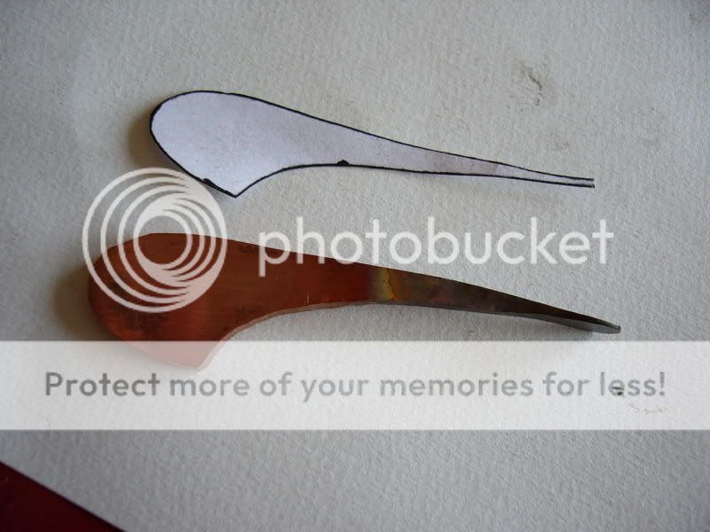

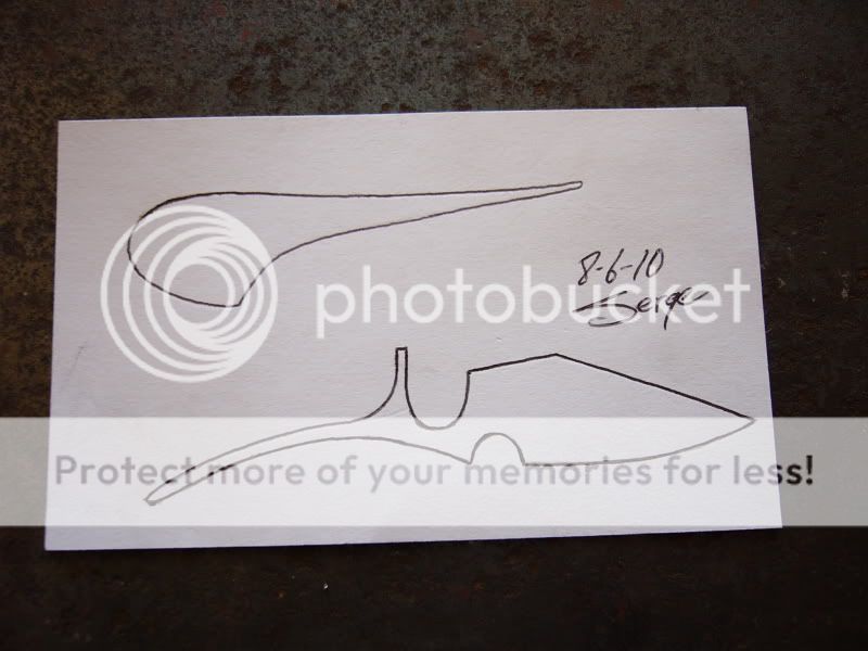

Hi all, I will do another WIP thread. This little knife is kind of a new concept for me as it is carved, something I hope to do alot more of. I've been trying to come up with something new so I think this knife is it. OK, first is the idea drawn up on a 3.5x5" card, the original drawing is on a piece of paper with several other designs that I will be making so I don't want to spoil it for you guys by showing you future projects :)Joking:)

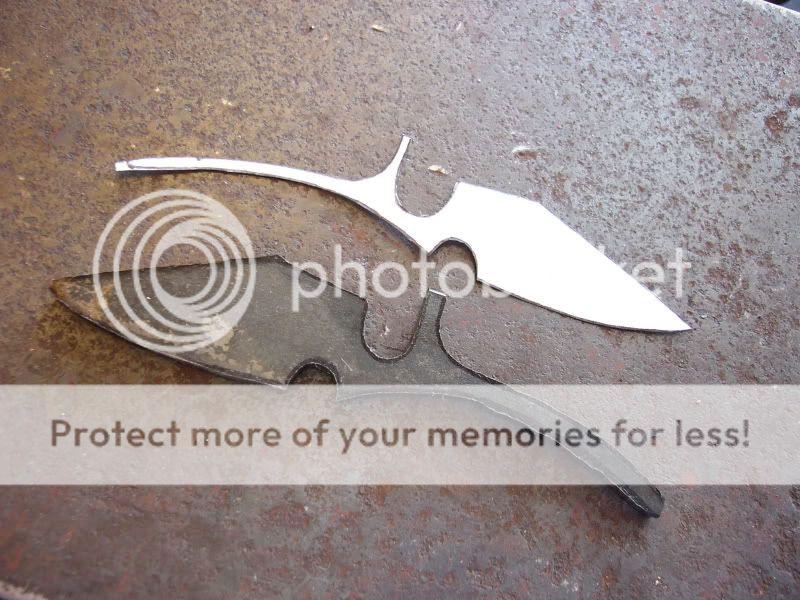

Profile cut out, 1080 steel, 1/8" thick.

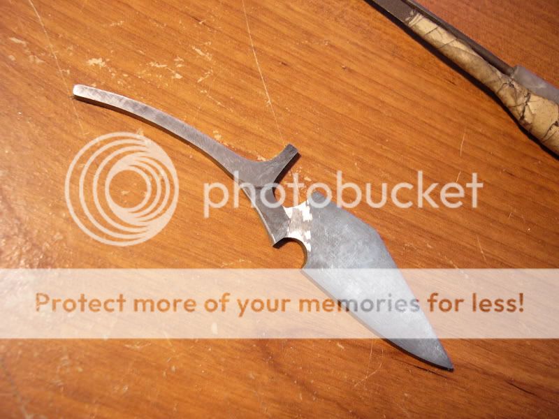

Ground flat.

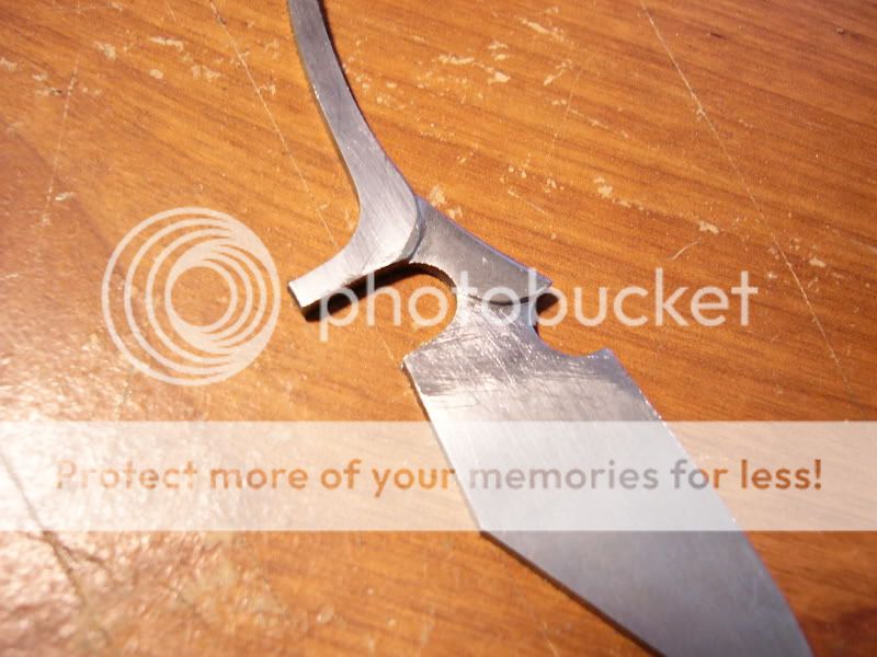

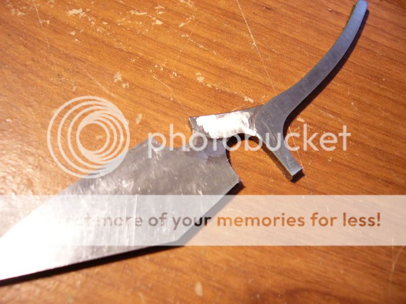

Beggining to carve the "segments".
The carving has been roughtly filed in.
I didn't really like the spine of the blade so to make the design flow better I modified it. The blade is still rough at this poing and needs ALOT more sanding to get all the scratches out. All carving was done with needle files and a Dremel.

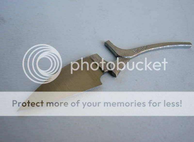

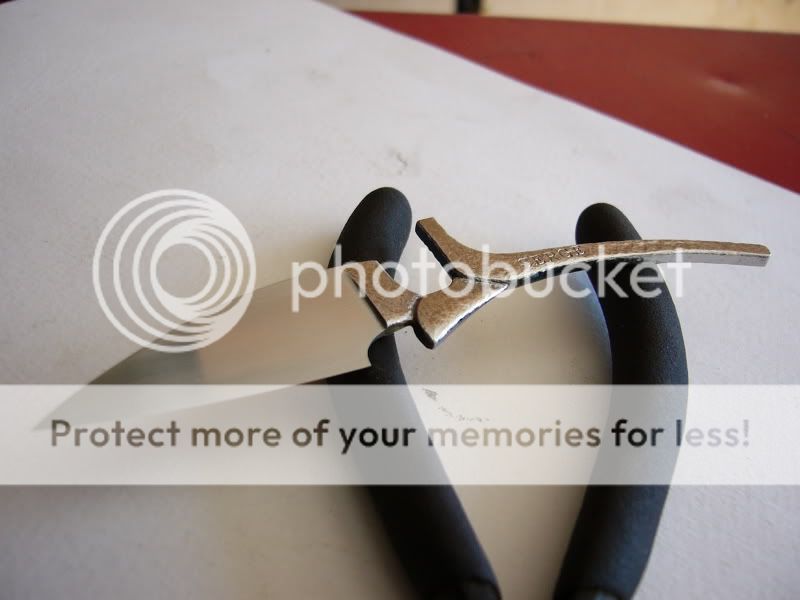

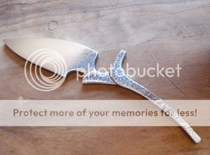

After finishing sanding the knife, I began texturing with a dremel and a carbide bit.

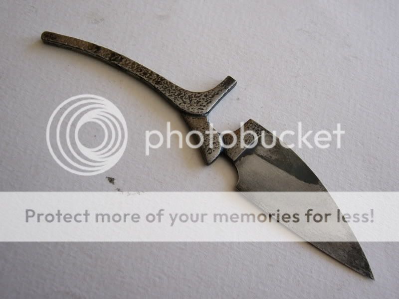

Everything has been textured and my name stamped.

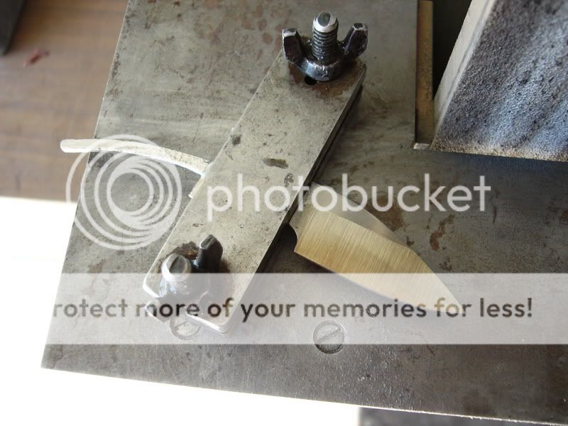

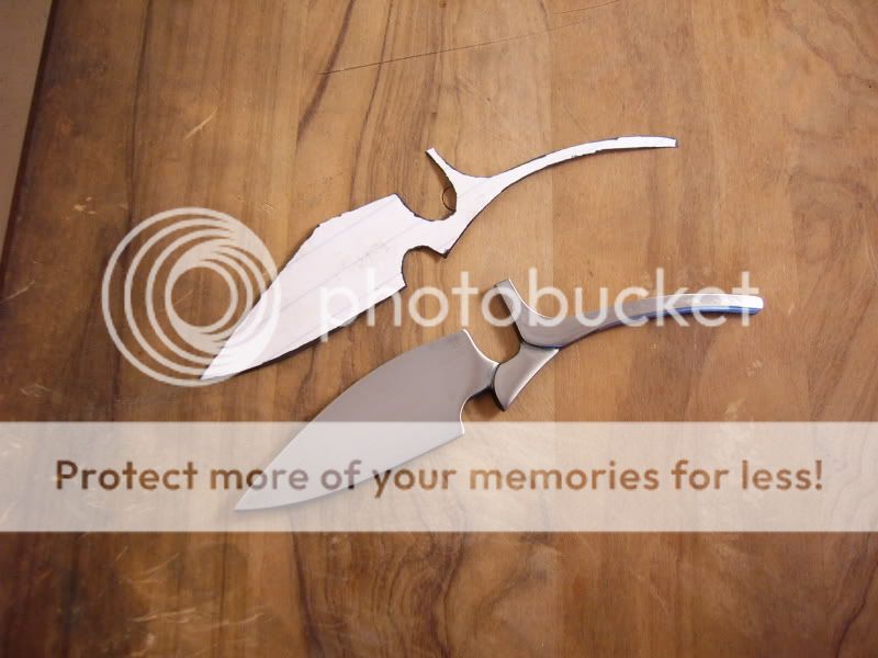

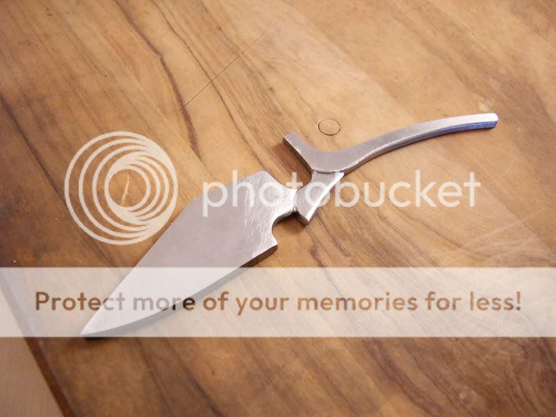

Beggining to grind.
Both sides flat ground.

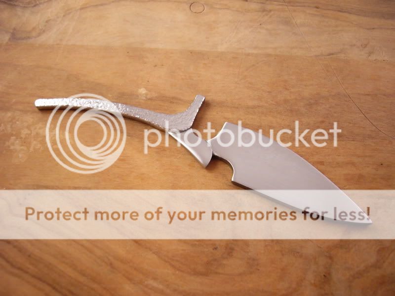

Blade has been handrubbed to 320 grit.
Then rubbed to 600 grit and ready for heat treating.

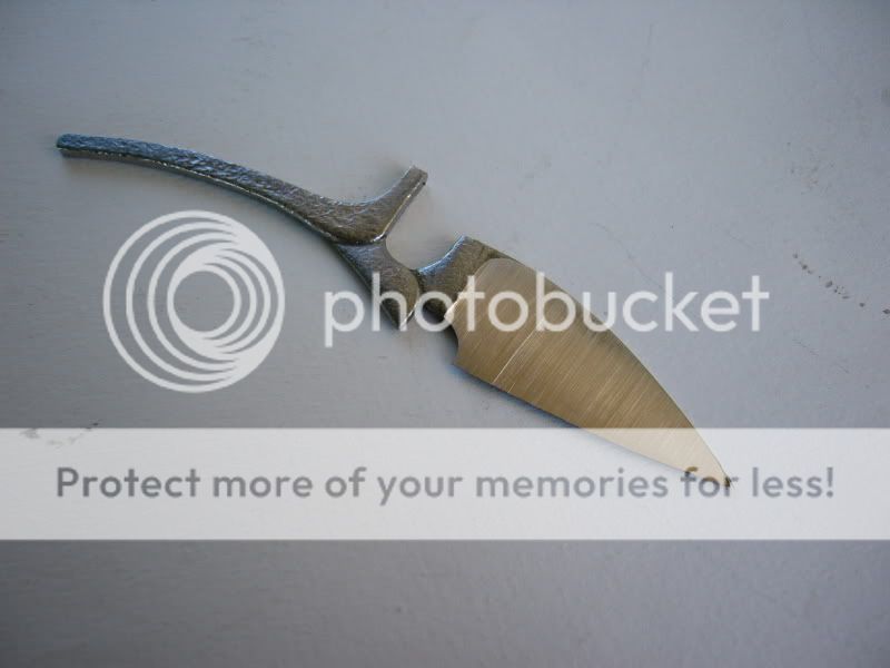

Blade after HT.

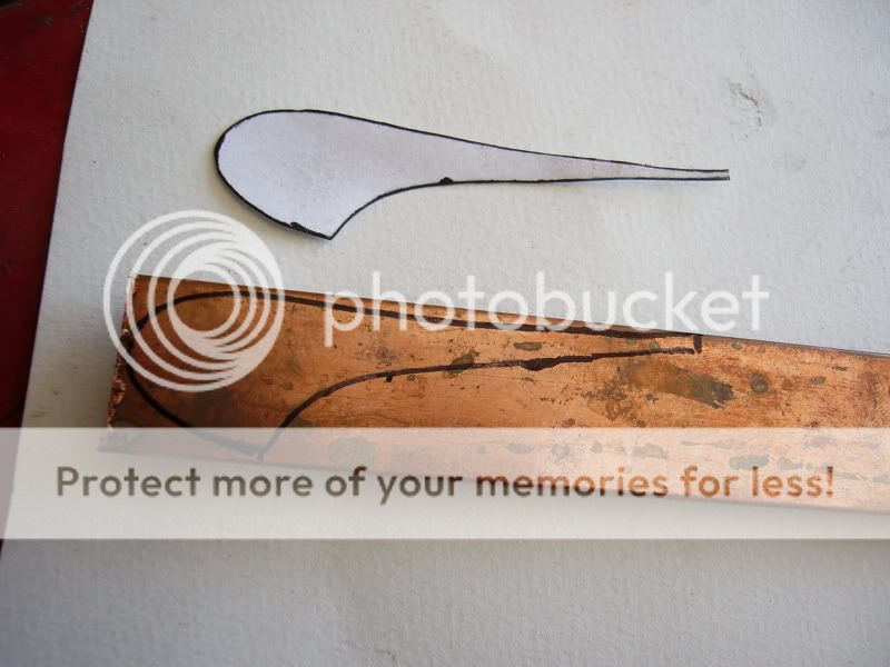

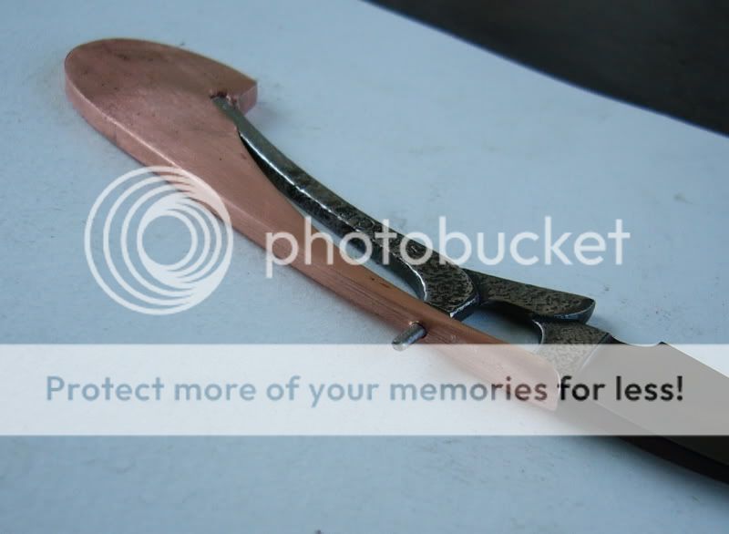

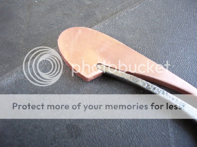

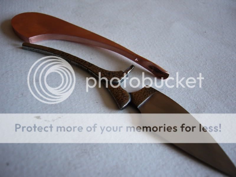

Now it's time for the handle. I transfer the design to a 1/8" thick piece of copper.

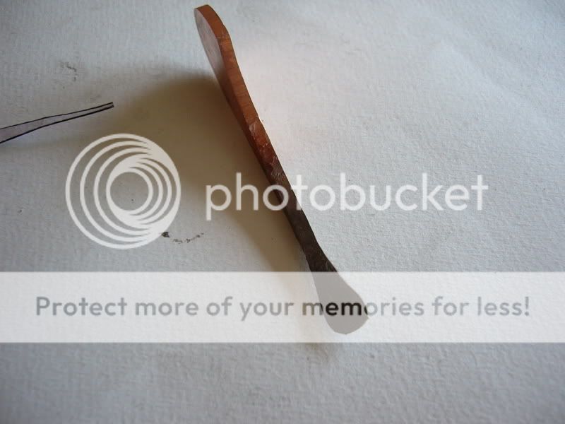

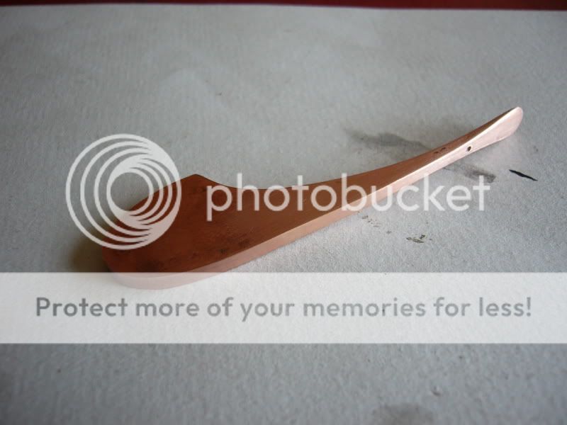

And cut it out. I then begin forging what will be like a "hood" that will go over the blade to help with holding the two parts of the knife together and will also provide a widened area for your thumb to rest on while cutting.
Then begin to clean it up with sandpaper.

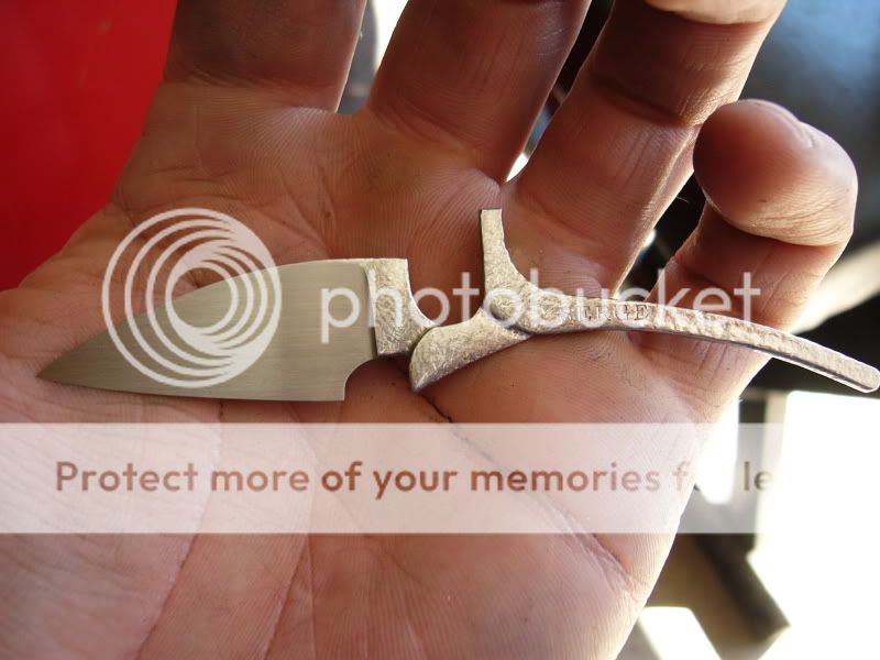

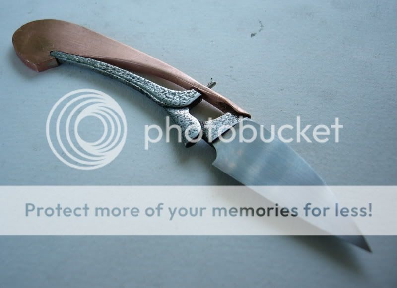

To give an idea of what the knife will look like.

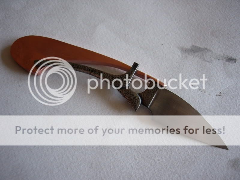

Hole drilled in the copper piece and the "post" beggining to take shape (done with a Dremel and files).
Assembeled! A groove was cut in the copper piece to accept the tang of the blade and friction fit (hammered in).
Hope you guys like it so far, more tomorrow.
